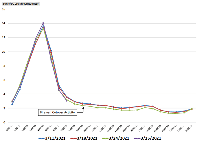

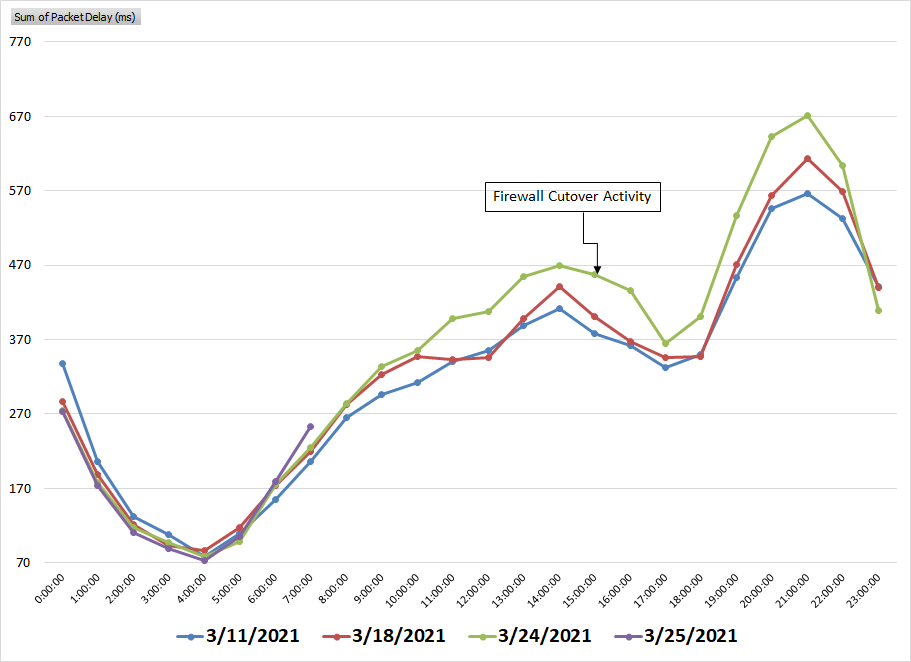

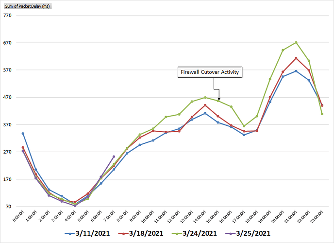

Any counter in Huawei LTE to show E2E packet delay, as new firewall cutover made DL user throughput and traffic volume degradation in our network, anyone have an idea, pls share
PDCP_DU_Delay/LOSS or discard

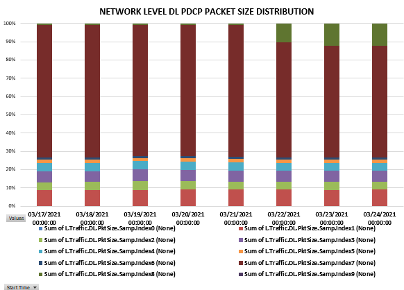

Yes, packet delay is increased, why it is increased? This is the question, i check 01 another thing PDCP index 8 samples are increased with decreased PDCP index 7 same time of the cutover, but nothing modified at radio end.
Anyone support to check, Index 8 increased and Index 7 decreased after Old to new Firewall cutover, nothing modified at radio end (e-NodeB), how this changed happened? and how to rectify this issue? as Traffic and DL user THB decreased with increased in Packet delay

Index 7: [1216, 1439] bytes
Index 8: [1440, 1503] bytes
Before that, transmission link can not send packet bigger than 1439 bytes, later it can.

At Radio end DL user throughput decreased with high DL Packet Delay.

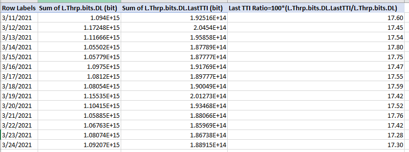

what is formula of throughput, how is ratio of last TTI traffic?
What is formula of packet delay, if radio packet delay ~ 500ms, I think it’s too large, I suspect of these value.

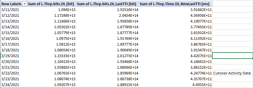

DL User THB=(L.Thrp.bits.DL-L.Thrp.bits.DL.LastTTI)/L.Thrp.Time.DL.RmvLastTTI/1000

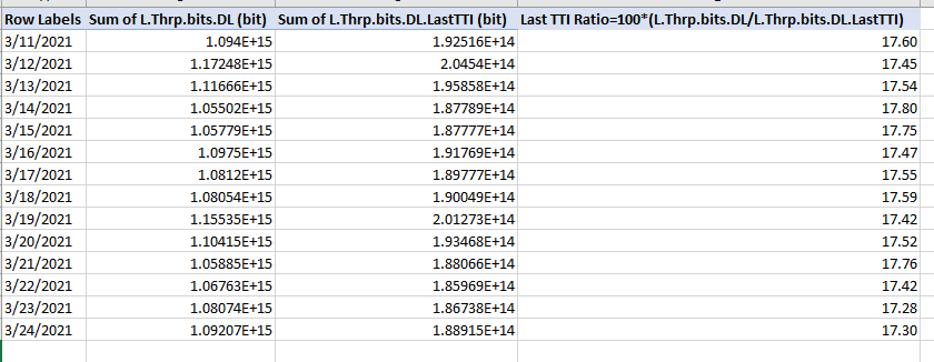

Last TTI Ratio Formula updated
It seems last TTI traffic ratio decreased a little. Please collect also in 1 table daily
L.Thrp.bits.DL

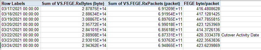

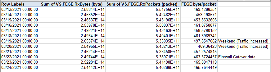

please check counters about: FEGE DL no of bytes received, packet received & calculate average byte/packet
Excluding 3G, only 4G sites
