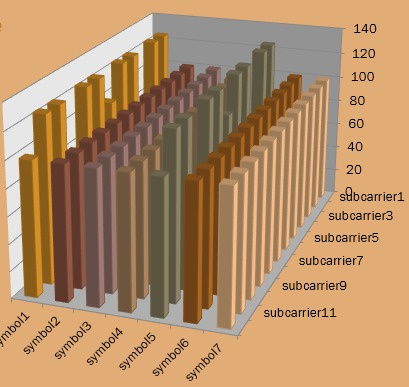

If someone uses Pa & Pb = 0 then this is condition of the RB. Won’t this condition adversely impact the network?
Given the higher powered Eb Resource Elements (RE) would just end up reducing the RSRQ.
PB is for enode power and PA is for RS power and I think both are inversely proportional.
RS power if increased can lead to eNB power decrease and throughput decrease.
It’s just a game of coverage and throughput.
It’s a detailed topic to grasp.
RRU power, antenna port, all has a role here.
Basically with PB we can change the EB power (Resources Elements in the symbol which transmits Reference Signal).
It can be made, equal to other RE, higher then other RE, or lower than other RE.
So my question is:
If I set those Type B Resource Element power more than the Reference Signal itself, then what should be the impact on network?
