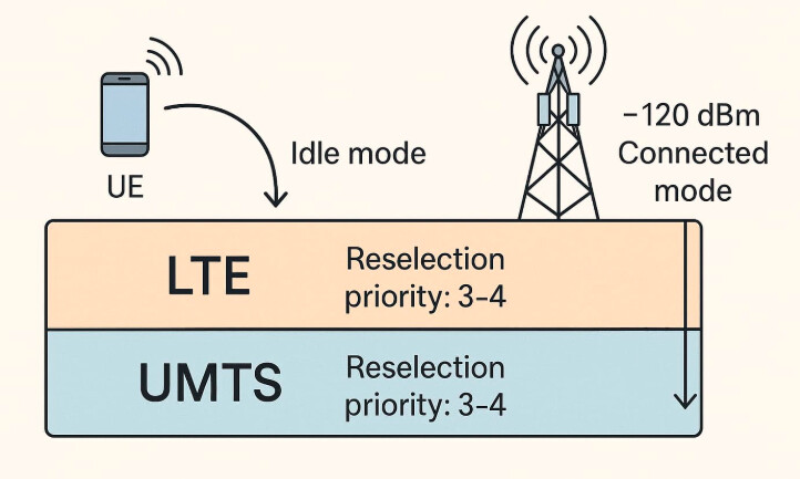

The best approach is to attract users from idle mode by setting higher reselection priorities for LTE.
For example, assign UMTS a reselection priority of 3-4 and LTE a priority of 5-6.
Oh, thank you! I’ll implement it.
What about the parameters for connected mode?
In connected mode, ensure the UE remains in LTE until -120 dBm.
Only when the signal drops below this threshold should an inter-RAT handover or redirection be triggered.
Reduce ThreshXhigh at the LTE layer to enable faster UE movement, and increase RSCP ThreshXlow at the 3G end.
