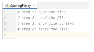

And let’s get started by learning: Python uses the # character as a comment indicator, or something that will be ignored when executing the code.
Therefore, let’s write our steps, and already include the Python comment character.
  • # step 1: open the file
  • # step 2: read the file
  • # step 3: show the contents of the file
  • # step 4: close the file
Okay, the hardest part’s over. The hardest part is not writing code in Python, but understanding and writing what you need to do – as we’ve done above.
With our programming logic created above, now just translate to Python – and believe me, it’s going to be simple. :wink:

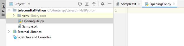

To start, we will create a “telecomHallPython” project in our "C:\Hunter\py" directory (1). (Remember that you can choose any other names/directories.) Let’s choose the option of “New environment using: Virtualenv” (2), and make sure that the location (3) is the same where we will store our project.
Note: we’re using PyCharm here. But you can use Jupyter Notebook or any other IDE you want, like VSCode.
All right, we’re all set to start writing our Python solutions. :wink:
We’re going to need a sample file, so we’ve created a “Sample.txt.”
And we created this file within the directory of our project - like we’ve see how to do it in previous tutorials (You can also create the file through PyCharm or Windows Explorer).
Tip: Python can access files anywhere, it doesn’t have to be inside the project folder. But we put it here to make it easier to demonstrate.
And to conclude, we created our Python file – we call it “OpeningFile.py”, which is the file where we’re going to write Python code.

We then have our recipe, our roadmap with the steps we must follow.
So we can paste these steps into our file.

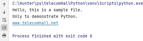

Running the code, we have the expected result:
That is, we have already achieved what we wanted: see the contents of our file!

Running the code
So the complete code of our solution today is this:
And the result, is as expected: we can see the contents of the file (1).
Notice that in fact, if we disregard the comments, our code is:
That is, in just 3 lines of very simple code we were able to complete our first project in Python!
