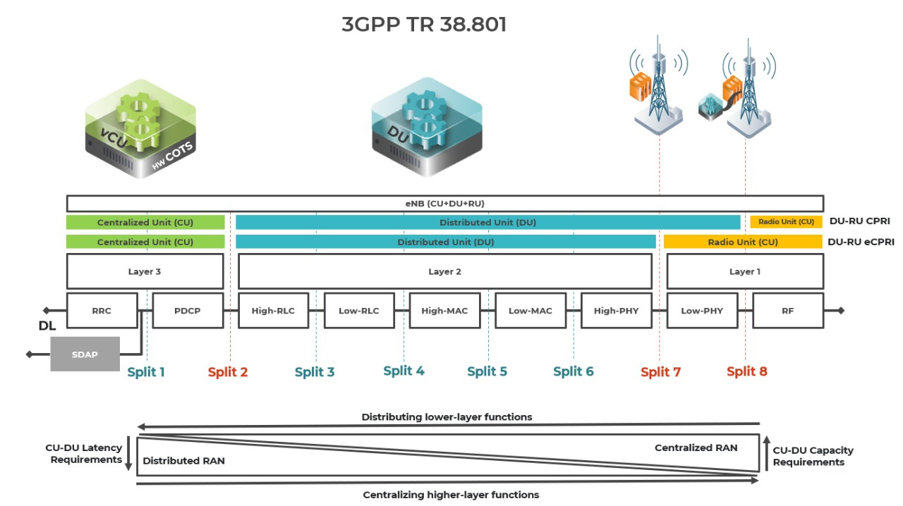

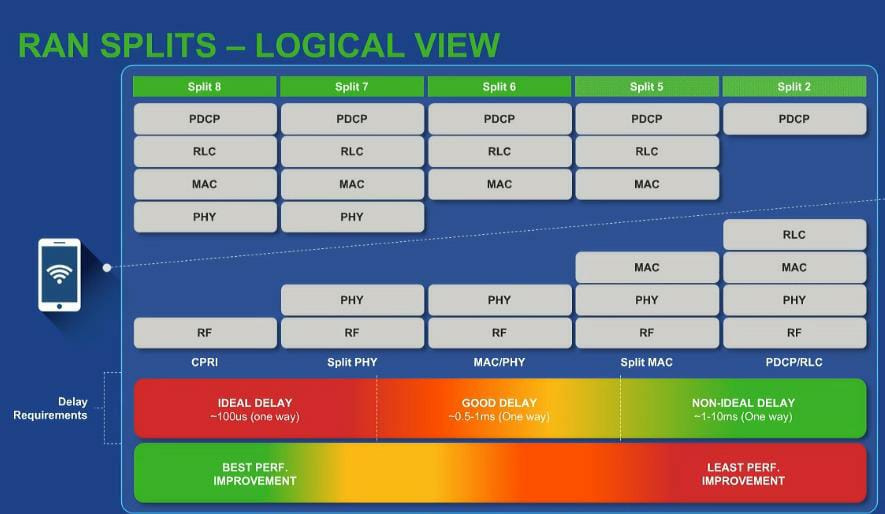

You may also are interested first on reading more about the functional splits in the physical layer (3GPP TR 38.801) and then start looking to OpenRAN itself.
This survey present a lot of data from theory to practical studies on the split options:
For reference, in the OpenRAN the mainstream right now for 2020 is up to split 2 for CU and then Split 7-2 (O-RAN Compliant) for DU+RU.
