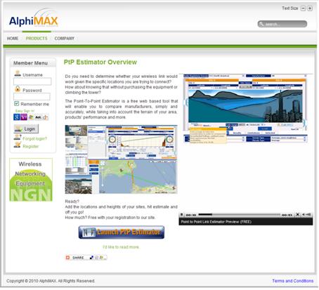

The site for direct access to our tool today is:
http://www.alphimax.com/ptp/overview

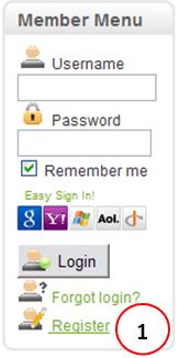

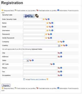

It’s very intuitive, and to get started, simply create a username and password for free. Simply click on Register (1) on that page.
Fill out the registration form with your details, as any registration. Wait to receive an email to confirm your account and you’re done. Now you can start.

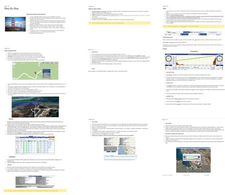

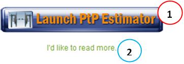

Well, back to the homepage, you have two options - apart from reading an introduction to the program and be able to watch a video in point: access the program directly (1) or read a good step by step available (2).
As the program must be new to you, I advise reading this introduction. There are 9 brief summaries of the main specifications of the program:
http://www.alphimax.com/ptp/getting-started.
(I will not be repeating information here once it’s clearly written by the program developer team). After reading the introduction, you can then login and access the program main page.

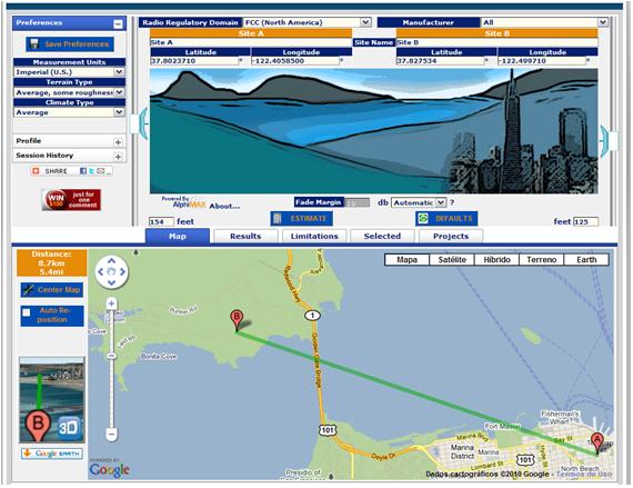

In the upper left, you set your preferences. You can adjust your Measurement Units (1), the Terrain Type (2) and also the Climate Type of the link (3). For example, in Climate, you can choose between medium, dry or wet.

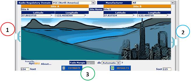

In the top center, you have a graphical representation of link (A - B). In addition to other adjustments as Fade Margin, it is interesting the interactivity to change the heights of antennas: just click and drag with the mouse (1) and (2). When all data are properly adjusted, then you click Estimate (3) and the link is estimated.

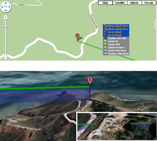

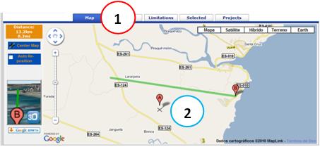

On Main - Map (1) - you have the option of moving the sites A and B. For this, simply click and drag the point (2) - the same way as you work with Google Maps. Incidentally, speaking of that, the program uses the Google Maps API, which makes it even more interesting, since the quality of these maps is a fact.

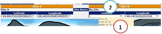

Of course you must have your existing sites. And for that, you can enter the exact coordinates (1) and even to change the name of your it (2).

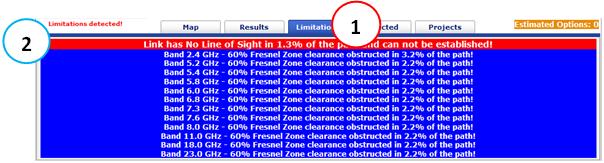

The flap Limitations (1) lets you check cases where your link has obstructions. Note that in this case, also flashes a red text with ‘Limitations Detected’ (2).

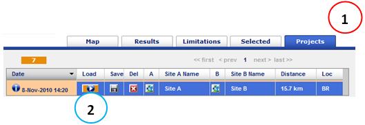

The Projects tab (1) keep all your projects executed. You can for example load (2) an existing project.
