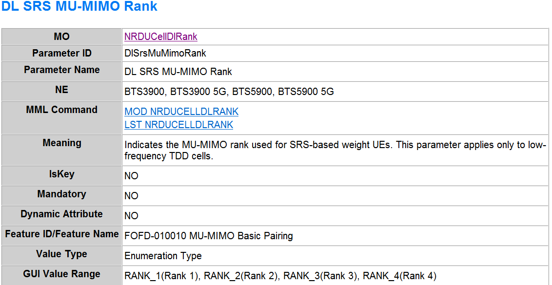

I remember that as 3GPP standard, max layer per MU-MIMO UE is 4 layers.
In Huawei MML command, it can also set max layer per MU-MIMO UE as 4.
