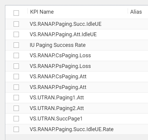

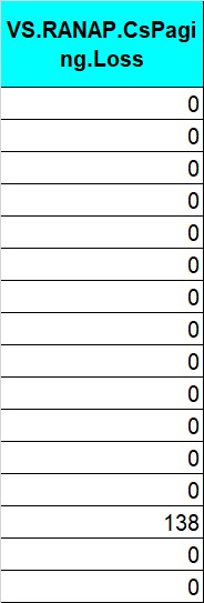

Or this cell wise paging KPIs:
VS.RANAP.CsPaging.Loss
If that one is 0, then you need to check at MSC level, the counters.

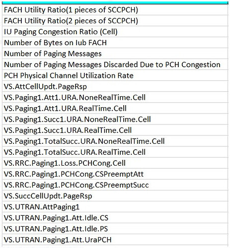

It’s not present in this template. Let me extract the other one.

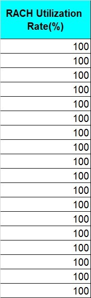

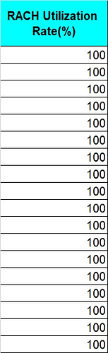

RACH success rate would count as well.
RACH Utilization %

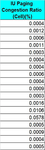

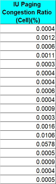

IU Paging Congestion Ratio (Cell)(%)

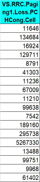

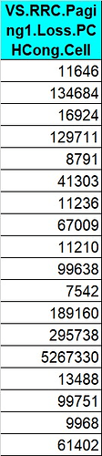

VS.RRC.Paging1.Loss.PCHCong.Cell
