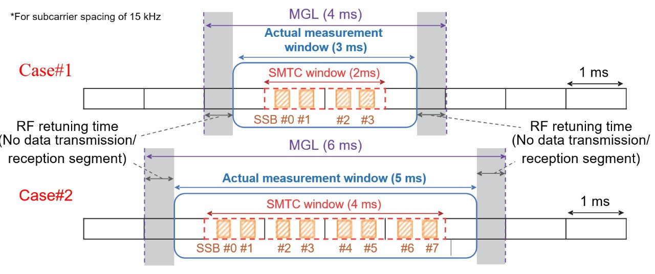

I am saying for measuring NR, SMTC is configured by eNB.
SMTC gives exact time when UE has to scan for NR SSB.
What I am trying to say is, MGL and SMTC should be overlaped in order to scan NR carrier (SMTC is confine din MGL).
If SMTC parameters are wrongly defined, or timing of LTE and NR are not alligned, UE cannot measure NR.
RRC Reconf failure can also happen in this case.
