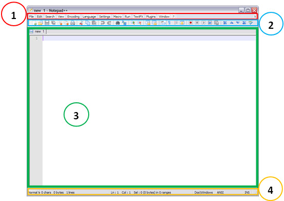

In the first area (1) we have the menus for the many possible actions (let’s say today about only a few major, you can explore all according to your needs). The main menus are shown as well as through buttons on the Toolbar (2). The main area (3) is the most intuitive of all - where the text is worked, and we also have a Status Bar (4) where some quick information are shown.

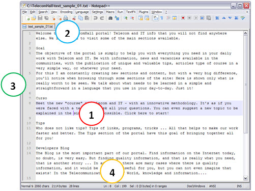

Note a few things already - that Notepad could have. The line where the cursor is on (1) is in light blue (highlighted). The file name can be seen in its corresponding guide (2) - this is useful when we have more than one file open, and switch between them. On the left we see the line numbering (3), and at Status Bar we can see for example in which column the cursor is (4). Among other information.

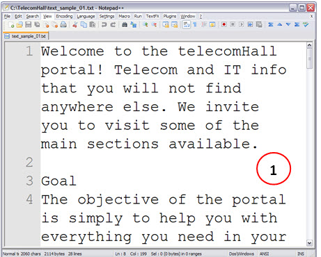

Now suppose you have to give a zoom, because the letter is very small and you want to read a certain passage better. Simply hold down the Control key and roll the mouse wheel. Notice that the zoom is applied or removed as desired - without having to change the font size (1)! (Then when you print will not have a giant text by mistake).

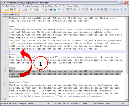

Now imagine you have a few snippets of text that need to be moved (cut into one place, and pasted into another). To do this, you can simply select the section and drag it to wherever you want (1) - including another file!

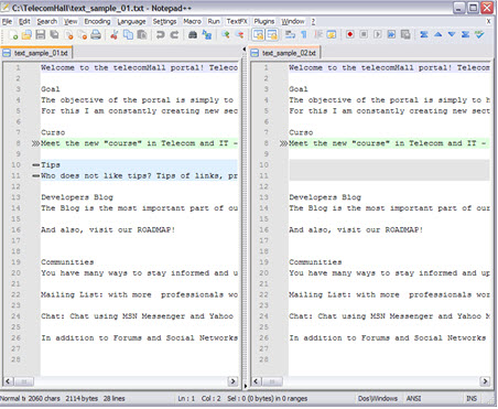

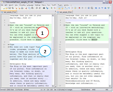

Suppose you have a text file, and it has sent a colleague to make some corrections issues. Upon receiving this file (let’s call here sample_text_02.txt), how do you see what has changed by your colleague?
To do this some with Notepad++, open the first file, then open the second file, and access the Menu: Plugins (1) → Compare (2) → Compare (3) and see what happens.
Well, so now you can see the differences, but before we talk about three buttons with options (actions) are important in this case: Synchronize Vertical Scrolling (1), Synchronize Horizontal Scrolling (2) and Word Wrap (3).
With these three buttons pressed, the scroll bars are vertical and horizontal sync, and enjoy a line break that allows us to see the entire line. Note however that the Word Wrap affects only the display - the numbering of the lines remains the same (for example, the title ‘Tips’ is always in line 10). (Note also that when you make a comparison, the synch buttons of scroll bars are enabled already).
Well, let’s examine the comparison. See that your colleague made a change in line 8: change the text ‘start’ to ‘BEGIN’. The paragraph is green, indicating that there is in both files, but shows what has changed. And the change is more prominent in dark green (1).
And when you move the scroll bars, the contents of two files simultaneously moves.

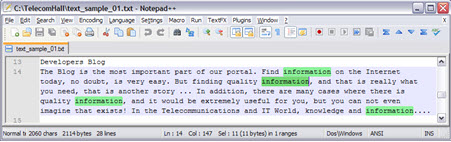

Back to our original file, and let’s see some other facilities. Double-click - or choose - any word, eg ‘Information’. See what happens: the word is highlighted throughout the file.

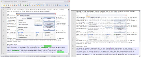

Now we will use the facility to find and replace. That the interface is very friendly: when you put the focus on the text, the interface becomes almost transparent, without locking your editing options.
You can also use Regular Expression in the polls for those who are already familiar with this powerful syntax.

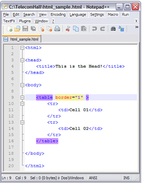

So, suppose you have to create a simple HTML file with a table composed of two cells.
Note: All programs usually have their associate Editors. However, for the most part, you can create programs using only Notepad or any other text editor.

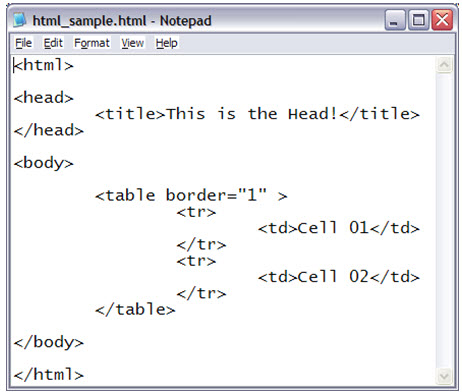

Then, the HTML code to create our page can be viewed using Notepad.
But now see the same file, open with Notepad++.
The features are numerous, as if you were using the editor of your specific language. For example, in the case of HTML, it colors automatically and properly texts.

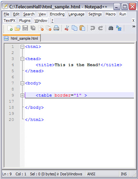

Also, it does indenting, and allows you to group parts of the text, hiding in due course. See the same example above, where you simply hide the entire area of the table simply by clicking the ‘-’. That in turn, when we click the sign of ‘+’, it displays the text back.
