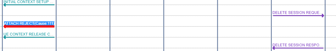

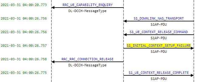

Could you send a picture of signaling messages?
Attached information that node B reject to MME

Try to request specific band/band combinations to reduce the size of the message
request to phone vendor you mean? and how it can be reduce the size of the message here? it interesting to know it can be reduced
In the UE Capability Enquiry message, the enodeb can request specific bands only so the ue capability Information becomes smaller specially in CA combinations
