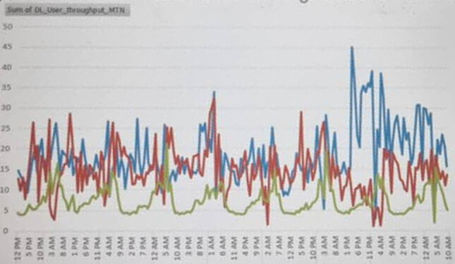

Throughput improved:
![DL_User_Throughput](/uploads/db2683/original/2X/7/76f55ceb61bb659f429d079b6dd2833b29c652a2.jpeg)
Yes because PRB increased.
