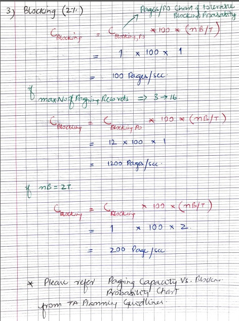

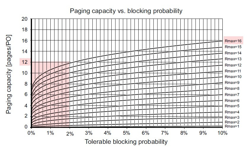

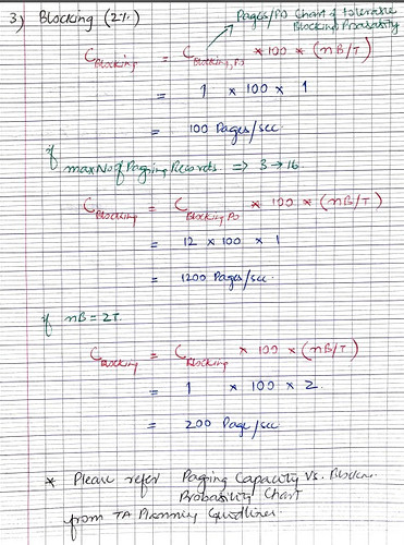

RBS paging capacity is determined by the number of
available POs per radio frame. This number is configured using the parameter
nB. Use these equations and charts to see how different values of nB vary the Paging Capacity. RBS Paging Capacity is dependent on 4 different criteria 1. CPU Load, 2. PDSCH Load, 3. Blocking due to PDSCH Limitations(nB is related here) 4. PDCCH Load.
