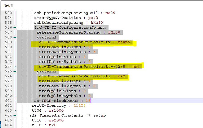

Regarding 5G NR, does anyone have experience with multiple TDD patterns?
Like in this example of N78:
Hello all.
TDD-UL-DL-Pattern field descriptions
dl-UL-TransmissionPeriodicty
Periodicity of the DL-UL patter, see TS 38.213 [13], clause 11.1. If dl-UL-TransmissionPeriodicty-v1530 is signalled, UE shall ignore the dl-UL-TransmissionPeriodicty

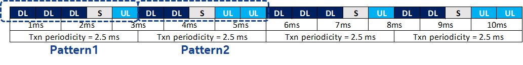

My question is do you see often 2 patterns used?
Yes, usage of 2 patterns can be seen for e.g.: when UL/DL slot ratio is used as 3/7.
E.g. of slot ratio 3/7
Wouldn’t it be easier to use just one pattern with similar parameters?
Why so complicated?
I mean one pattern provide enough flexibility with UL / DL slots and UL / DL symbols.
Everything can be achieved with one pattern, why do we need 2?
Because 2 patterns introduce more separation symbols, so some slight resources are lost this way.
I agree that one pattern may introduce delay, because UE needs to wait longer time for an uplink slot.
May be few patterns are standardised, as only pattern 1 will be used for case of 1/4 slot ratio.
It is not like in LTE, where are standard 6 or 7 patterns for TDD.
In NR is much more flexible a pattern.
