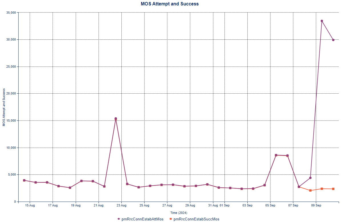

We are having a problem on the Customer network, possibly caused by a terminal where there is a sudden increase in MOS attempts and this ends up impacting RRC Accessibility.
It does not establish an ERAB and therefore it is not possible to identify which type of terminal.
Several actions were taken and none were effective in resolving it, and as soon as the error appears, it disappears without leaving any indication of the reason.
Has anyone ever experienced this type of behavior on the Network where they operate?

Does signalling attempts also increases?
Exactly.
The indicator of failures is it Attempts-Success.
The main Reason for is on increase Attempts…and low success.

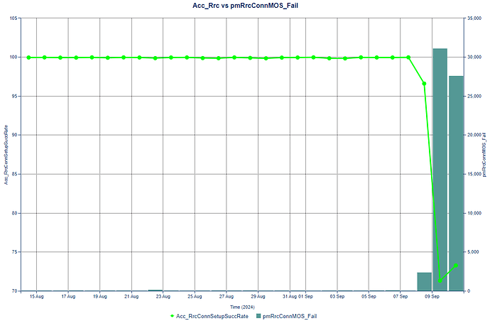

This problem is probably caused by a terminal, since it does not establish an ERAB, failure occurs in the RRC stage…

Thanks Guys, but it doesn’t make much sense in my understanding…
The problem is not in the RA process, and Timing Advanced is low.
