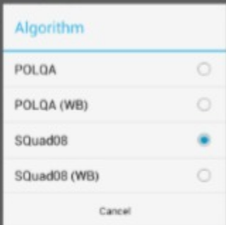

Check the ALGO that you are using.
You need to have POLQA and not POLQA-WB.

For my Drive Test tool these are the option i have:
  • If your network supports only AMR-NB then you need to select POLQA or SQuad08.
  • If your network is AMR-WB, then you need to chosee the algo POLQUA(WB) or SQuad08 (WB)
