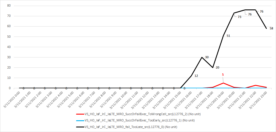

when i activate the MRO feature i have notice that the indicator
VS_HO_IaF_IrC_IaLTE_MRO_fail_TooLate_src was increase from zero to 76 per hour while the other indicators for TooEarly & ToWrongCell are almost Zero as shown in the below figure.
is it a normal behavior ?
How can i know that this feature is functioning well ?
Is there other indicator needs to check ?
