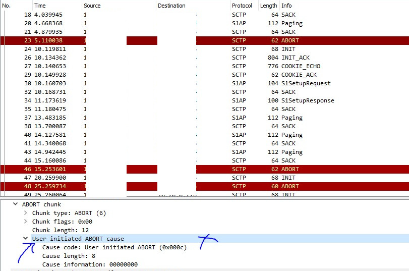

Hello Experts
From below S1AP Trace after integrating a new eNB to the network, the MME is responding with S1 Abort response and the cause is: User initiated.
Any help on resolving this?
MME Vendor = Huawei.
eNB= AirHarmony 4000

Dear, what is S1 setup response detail?
I can see abort message from both MME and eNB sides.
Please share S1 setup response nessage detail.
It’s on SCTP layer.
Please involve Transport team.
And can check MME, and node end SCTP parameters.
Do you have assigned BWP logs also?
At some point the S1AP is successful but then aborts.
what is parameter of S1_MME setup timer and S1-MME retry timer if initial setup failed with MME.
