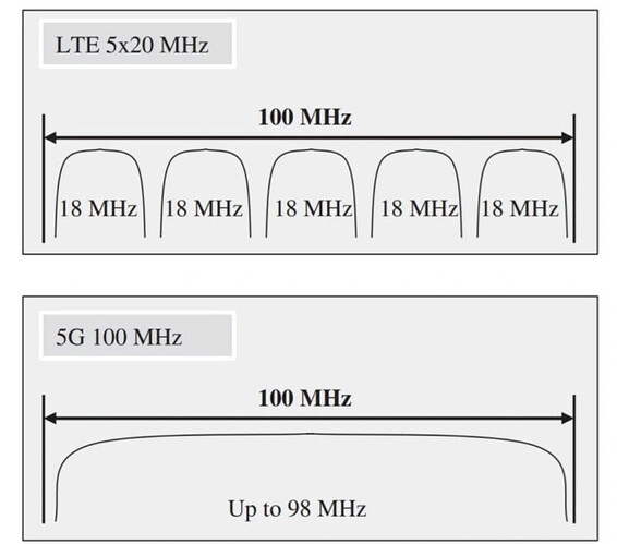

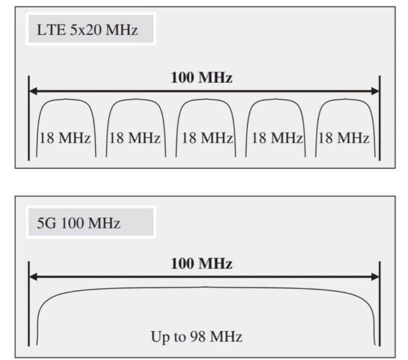

  1. In the Carrier Aggregation mode, due to the band guard, part of the frequency is wasted.
  2. In Carrier aggregation mode, signaling information is sent separately in each carrier, which causes a waste of resources.
  3. In the Carrier aggregation mode, there is a need for a load balancing to balance the information of the carriers.
20 MHz bandwidth is used in frequencies below 3 gigabytes, especially in FDD mode.
100 MHz bandwidth is mostly used in millimeter wave frequencies (24-39 and above 60 GHz)
That’s one reason why 100 MHz bandwidth is more efficient in 5G NR compared to 4G LTE.
