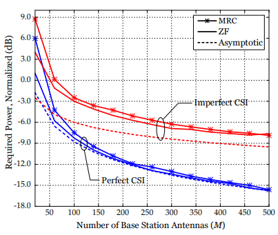

We next consider the required transmit power of each user that is needed to reach a fixed spectral efficiency. Fig. 3 shows the normalized power (pu/σ2 ) required to achieve 1 bit/s/Hz per user for different M. The asymptotic curves are determined from Equations (29) for the case of perfect CSI, and (39) for the case of imperfect CSI. As expected, for large number of base station antennas, by doubling M, we can gain approximately 3 dB and 1.5 dB in power with perfect CSI and imperfect CSI, respectively. Furthermore, we can see that when M is large, i.e., M/K > 6, the difference in performance between MRC and ZF is less than 1 dB.
Fig. 3. Required power versus the number of base station antennas for 1 bit/s/Hz per user. Here K = 10.
Source: Uplink Power Efficiency of Multiuser MIMO with Very Large Antenna Arrays paper.
