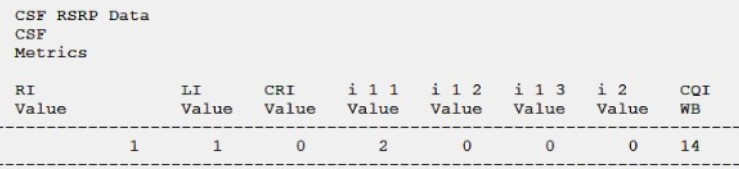

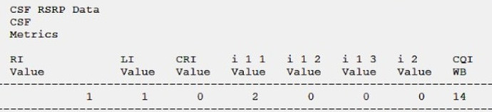

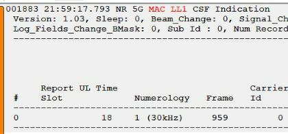

Open Ucidataind msg, in which you can find CQI, PMI, RI values.
You may check under this msg MAC LL1 CSF Indication.
Where is CQI, PMI and RI information?
It means in Actix 5G message browser, search for mac ll1 csf.

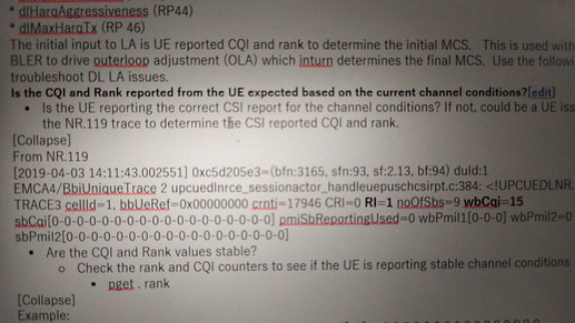

I already pull out the bbtrace from system.
Without any CQI reported it mean initial MCS not used for Ericsson?
Reviewing the logs based on your suggestion or trick …like first DCI MCS value.
Got the sample for bbtrace.

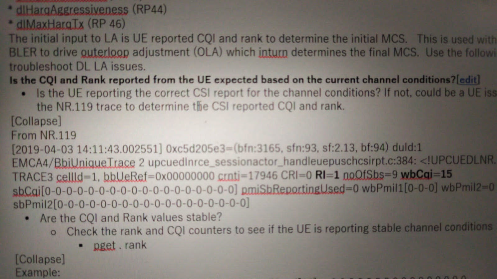

But I can see cqi=15 in this trace.
Did you set the param for 15?
It is a very aggressive value.
Better start with 4 or 6 for initial cqi.
Only wideband cqi 15 is in the picture. Subband cqi is 0 all over.
This NR.119 trace does not help you @Vicky because it just provides reported cqi, as mentioned in highlighted part in yellow.

NR.119 is to get CQI & RI in Ericsson , that’s correct @RFSpecialist.
Similarly we have other event to get MCS.
Still checking more detail with PDU.
Such information is not available on lib, or anywhere so easily.
MCS is a selection for downlink of the scheduler based on CQI from NR119 trace.
You will not get MCS in NR.119 trace.
