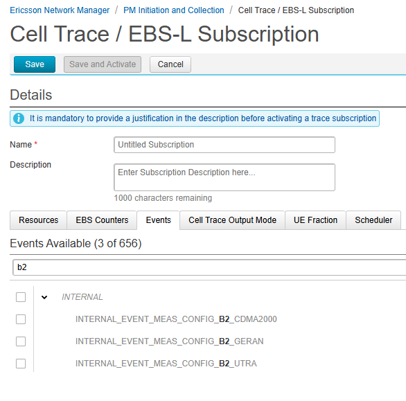

Can someone please guide how to fetch B2 measurement report from Ericsson enb?
Hi, @Sooraj, I don’t know what exactly you need, I believe it is in Cell Trace
Hi @vlr9999 thank you so much, yes I was actually looking for measurement report from UE related to SRVCC. I believe is it B2 measurement report we need to look for? Please confirm

Yes — B2 is the right event for SRVCC, and vlr9999 pointed you at the correct tool (Cell Trace). Tying
it together:
Why B2: SRVCC to UTRAN/GERAN is triggered by measurement event B2 — “serving (PCell) becomes worse
than threshold1 AND inter-RAT neighbour becomes better than threshold2.” That’s the two-threshold
event that says “LTE coverage is fading and there’s a 3G/2G cell worth moving the voice call to.” So
for SRVCC you’re looking for the B2 measurement report carrying the UTRAN/GERAN neighbour, not A3/A5
(those are intra-LTE / inter-freq LTE).
How to capture it on an Ericsson eNB — Cell Trace (CTR):
  1. Start a Cell Trace recording (from ENM/OSS, or on-node). For SRVCC you want the UE measurement +
    RRC events, so include the event group covering RRC (INTERNAL_PER_UE… / UE_MEAS events) and the
    handover/SRVCC events.
  2. Filter to the UE/cell during a call that undergoes SRVCC (or run it broad and find the SRVCC
    sessions after).
  3. Decode the CTR in a trace tool (TEMS Investigation/Discovery, or the Ericsson CTR decoder). Look
    for the RRC MeasurementReport with measResultListUTRA / measResultListGERAN populated and the
    event id = eventB2 — that’s your UE measurement report for SRVCC.
  4. The full SRVCC sequence in the trace: B2 MeasurementReport (UE) → eNB decides SRVCC → Handover
    From EUTRA Preparation Request / SRVCC PS-to-CS toward MME → HO Command to UE → UE leaves LTE.
    The measResult in that B2 report is the RSCP/EcNo (UTRAN) or RxLev (GERAN) of the target the call
    handed to.
Two checks if B2 never fires in your trace:
  • The eNB must be configured with the inter-RAT B2 thresholds and a UTRAN/GERAN freq relation, or the
    UE is never told to measure/report the target RAT — no B2 possible. Confirm the inter-RAT
    measurement + SRVCC feature config on the cell.
  • Confirm the UE is on a VoLTE call (SRVCC only applies to an active CS-equivalent bearer / QCI 1) —
    no voice bearer, no SRVCC, no B2 for it.
So: B2 is correct; capture it via Cell Trace, decode for RRC MeasurementReport with eventB2 +
measResultListUTRA/GERAN. That report is exactly the UE measurement that drives the SRVCC decision.
