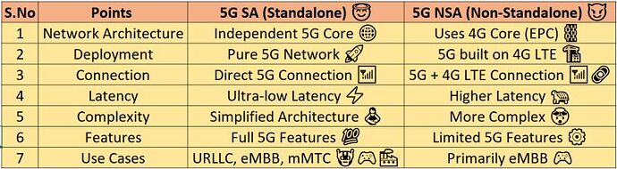

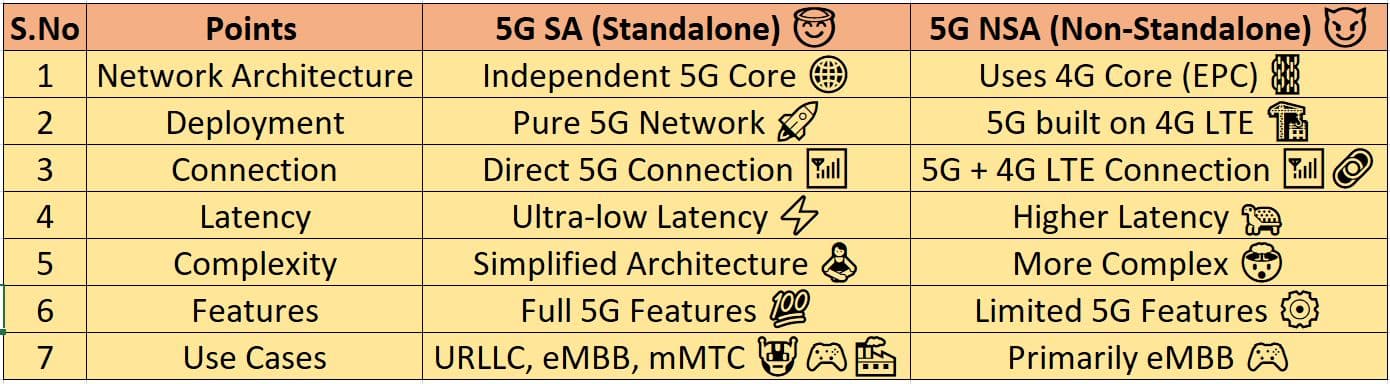

Main Differences between 5G SA and NSA:
Network Architecture :building_construction::
  • 5G SA (Standalone) :innocent:: Independent 5G Core :globe_with_meridians:
  • 5G NSA (Non-Standalone) :smiling_imp:: Uses 4G Core (EPC) :chains:
Deployment :construction::
  • 5G SA :innocent:: Pure 5G Network :rocket:
  • 5G NSA :smiling_imp:: 5G built on 4G LTE :brick:
Connection :satellite::
  • 5G SA :innocent:: Direct 5G Connection :signal_strength:
  • 5G NSA :smiling_imp:: Dual 4G/5G Connection :gear:
Latency :stopwatch::
  • 5G SA :innocent:: Ultra-low latency :fire:
  • 5G NSA :smiling_imp:: Improved latency, but not as low as SA :ocean:
Use Cases :dart::
  • 5G SA :innocent:: Enables advanced use cases like URLLC and mMTC :racing_car::factory:
  • 5G NSA :smiling_imp:: Primarily focused on enhanced Mobile Broadband (eMBB) :globe_with_meridians::iphone:
In other words, 5G SA is pure 5G, while 5G NSA is 5G with a β€œleg” on LTE.
