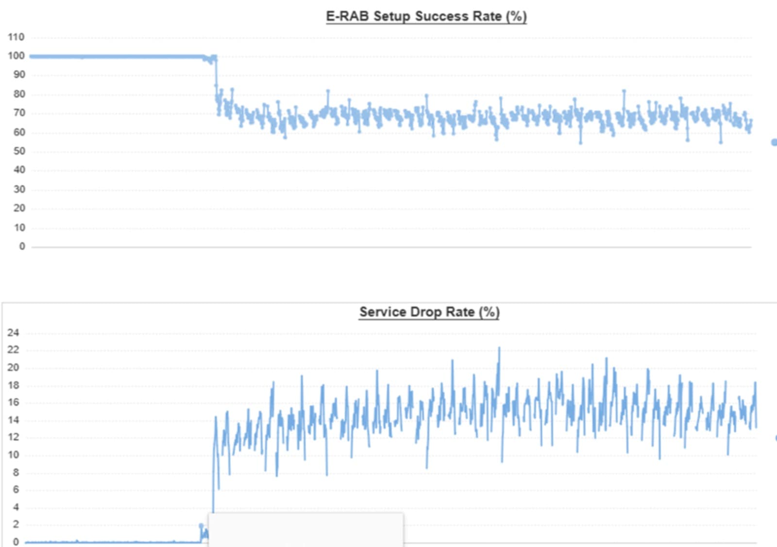

Hi friends!
Have you ever experienced a sudden degradation of all KPIs in an LTE cell (Ericsson) that was not caused by:
  • Off-baseline parameters
  • Missing neighbors
  • PCI conflicts
  • Physical issues or alarms
I have already reset the Baseband and the RRU, and the other cells on the same site are not affected.
Could this still be a Baseband failure, or should I investigate other potential causes?
What is the cause of the failure, and which vendor equipment is involved?
At Ericsson.
All KPIs have degraded, including accessibility, mobility, and retainability.
In Nokia, I have often encountered this hanging issue in 80% of cases.
A reset usually improves the situation, but in some cases, R&D team intervention is required, and the root cause is found to be a hardware fault.
