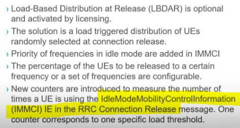

I see in feature description that this feature is using IMMCI.
IMMCI overrides any cellReselectionPriority information sent in
SIB3, SIB5, SIB6, or SIB8 in the System Information
