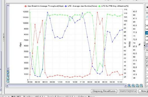

Please any parameter setting strategy for load balance between LTE 700 band and LTE CA 1800 band cells?
Vendor is Huawei.
L700 band cell:
L1800 band cell:
Same sector of same site.
Any advise to balance users and improve throughput?

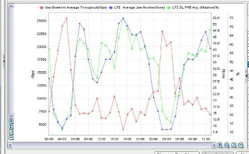

I need to load balance traffic between L18 and L26/L21.
My L18 taking majority of users approx 200 active users but L26/ L21 combined carrying only 50 users
