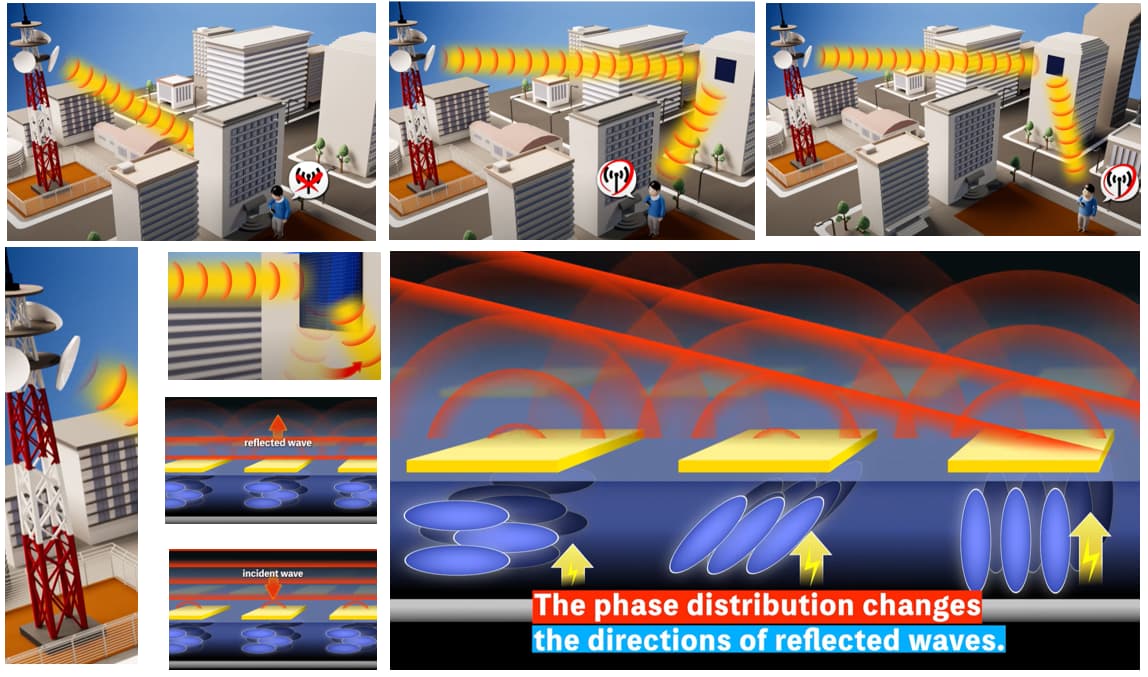

5G and 6G communications are expected to be utilized in a variety of fields.
However, the radio waves (mmWaves) to be used in 5G and 6G are difficult to reach over long distances.
Because mmWaves have a strong linearity and are easily blocked by obstacles.
To solve this problem, a liquid crystal metal meta surface reflector can be used.
So it is now possible to control the direction of reflected waves - without changing the angle of the reflector itself!
“Controlling the direction of reflection without changing the angle of the reflector.”
This is how it works:
  • The reflector includes a structure in which the “LC” between the “reflection elements” and the “ground electrodes”.
  • LCs are controlled by TFT.
  • So it is possible to control the orientation of LC by applying a voltage.
  • The orientation of LC molecules changes the phase of reflected waves.
  • The phase distribution changes the directions of reflected waves.
