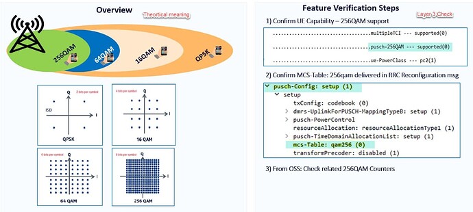

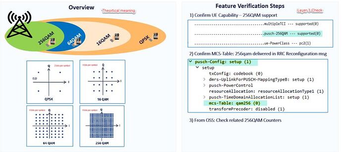

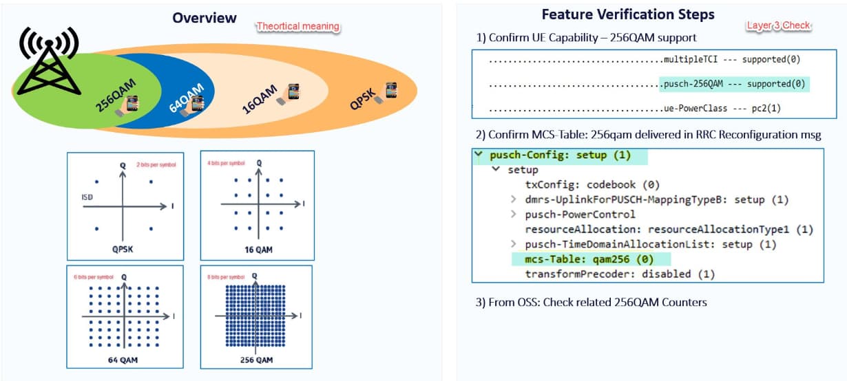

How can we verify 4G & 5G UL 256 QAM functionality from Field/L3 messages?
- For 4G Part:
UL 256QAM requires that UEs meet all of the following conditions:
For MR-DC UEs, The value ul-256QAM-r15 in the UE capability message is supported.
For other UEs: The value of ul-256QAM-r14 or ul-256QAM-perCC-InfoList-r14 in the UE capability message is supported.
- For 5G Part:
pusch-256QAM should be included in the UE Capability message, as shown in the figure below.
During Field testing, Check that 256QAM mcs-table is delivered in the RRC Reconfiguration message(This should be applicable for both 4G & 5G)
