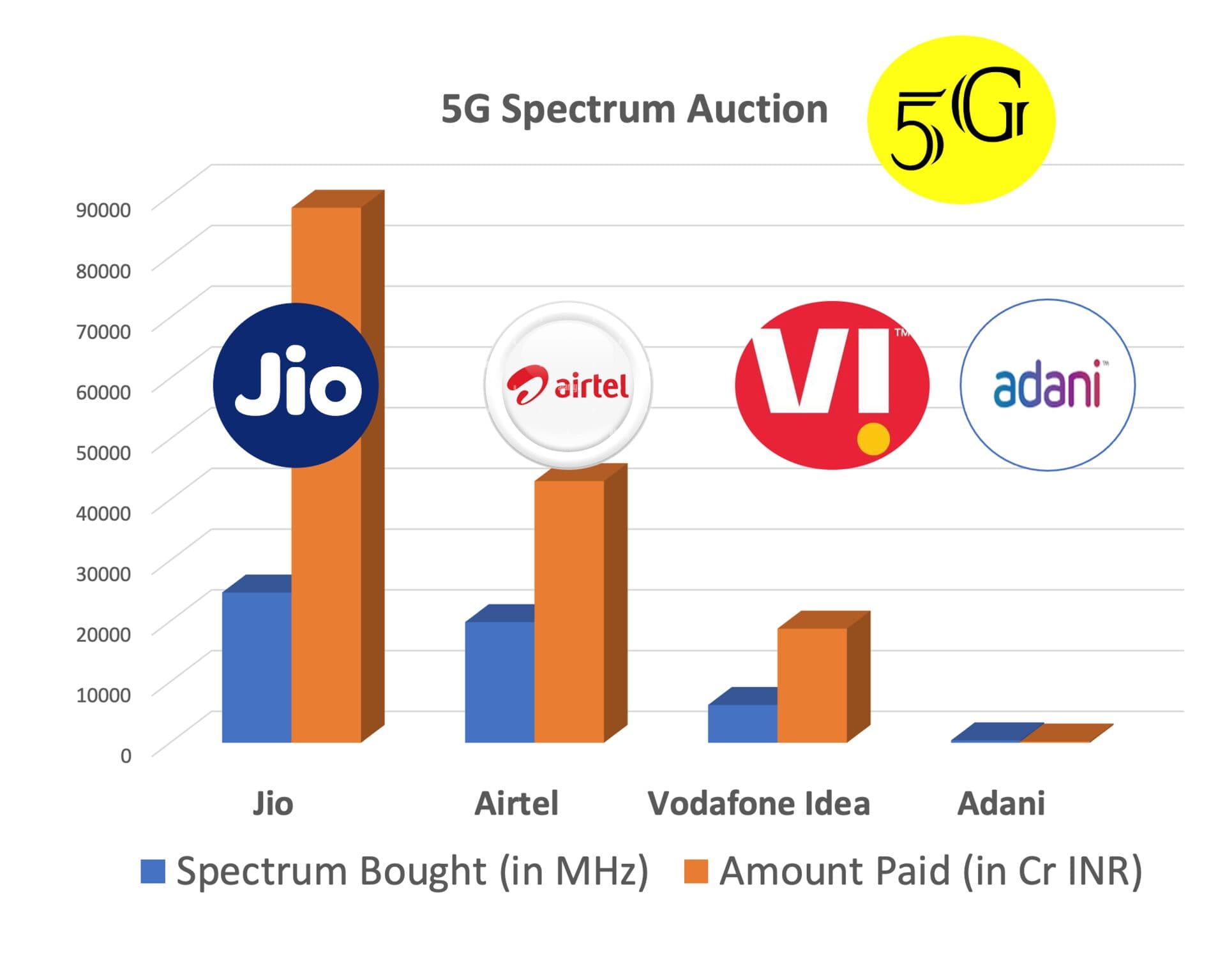

Total bid amount 1.5 lac Crores INR
The total spectrum on offer was 72 Ghz and 71% i.e. 51.2 Ghz was sold
Jio has acquired 24,740 MHz spectrum at a price of 88078 Cr INR
airtel has acquired 19,868 MHz spectrum at a price of 43084 Cr INR
Vodafone Idea Limited has acquired 6,228 MHz spectrum at a price of 18799 Cr INR
Adani Group has acquired 400 MHz spectrum at a price of 212 Cr INR
Jio is the only company that has acquired a 700 MHz band spectrum in all 22 circles.
5G Network rollout to start as early as Oct’2022
Cabinet scrapped the need for upfront payment for winning bidders, and allowed companies to pay in equal annual installments over 20 years.

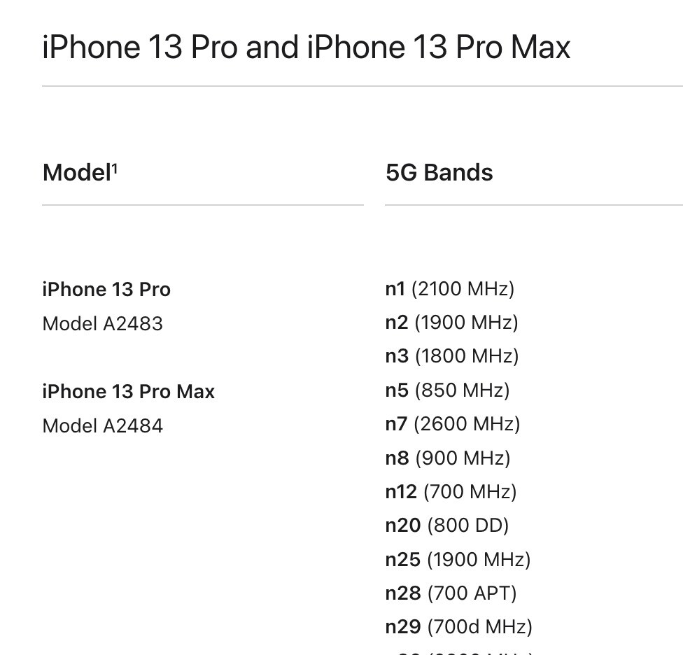

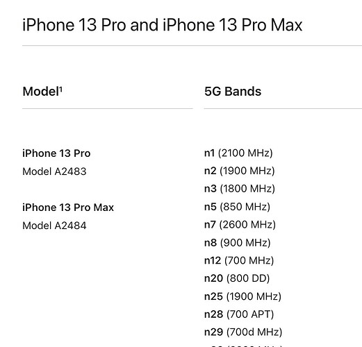

Can you give full pic showing supported band for iPhone?
Let me reframe the question: L700 can work fine in SA mode but it doesn’t support in NSA mode.
As Anchor on L700. Is that true?
Superior propagation of 700, it’s APT 700 in India unlike US.

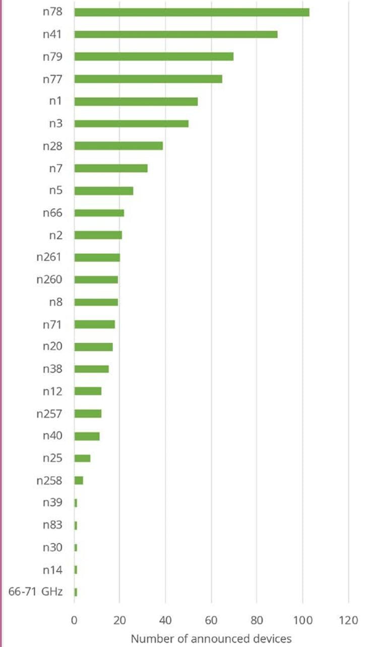

Higher n28 devices today:
