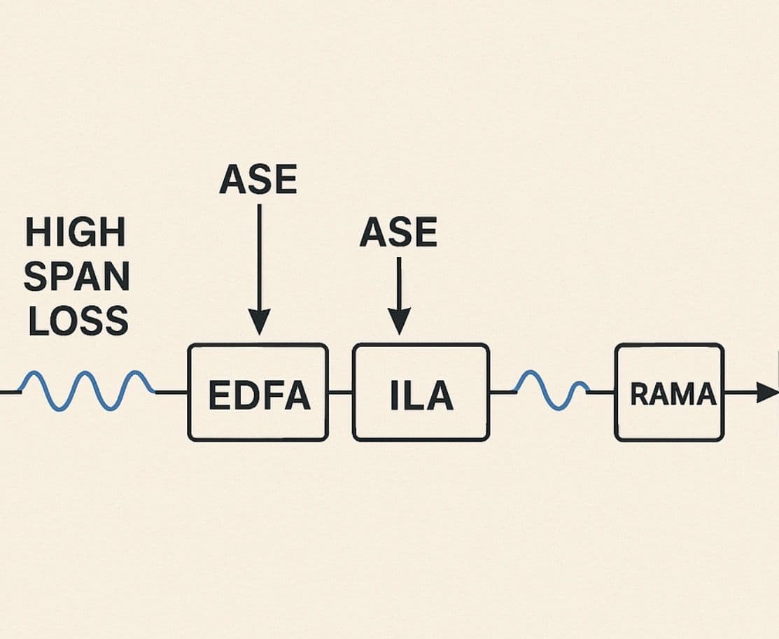

- Expect high span losses and multiple fiber spans in long-haul DWDM networks.
- To compensate, you’ll need multiple cascaded amplifiers along the path.
- EDFA amplifiers are commonly used, but they introduce ASE (Amplified Spontaneous Emission).
- ASE is a form of noise that degrades the OSNR (Optical Signal-to-Noise Ratio).
- So while EDFAs boost signal strength and extend reach, they also inject noise into the system.
- After several ILAs (In-Line Amplifiers), the OSNR degradation may require gain equalization and regeneration stages.
- Raman amplification can also be used to improve overall system performance.
- Managing gain tilt and power flatness is essential to maintaining signal quality.
