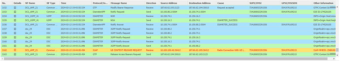

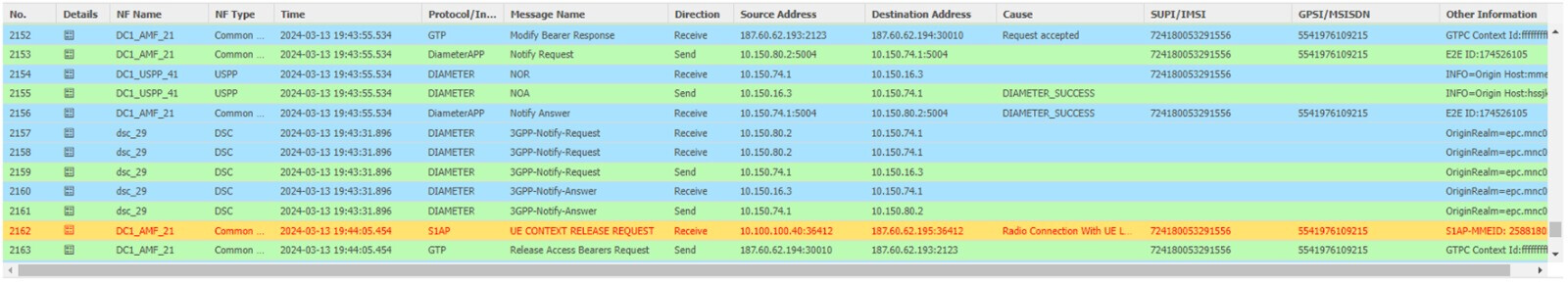

From Core side the device established a Session with the Core, PGW sent the IP Address to the device.
But in the Tcpdump we could not see any packet going out eNodeB.
Seems that the eNodeB is not sending traffic at all from this device or packets are getting lost somewhere within eNodeB.

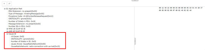

Core logs show UE Context Release due to Radio Connection Loss.

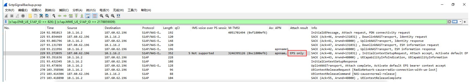

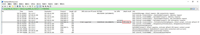

Can you share PCAP?
When you reprogram m2m SIM card to work in LTE, it should work provides operator gives valid IMSI APN.
Is the IMSI valid in the operator work?
I saw the pcap… Looks IMSI is valid and does EPS attach.
Where is it failing ?
I don’t think this is not a sim card issue.
Yes, this is right.
I believe you are using a commercial UE, Android or iOS.
After attach UE is releasing immediately with a cause radio connection with UE lost.

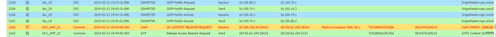

At MME logs we see UE Lost. It attaches, sets up PDP context and drops 10 seconds later.
But cause is radio, why do you search on Core for attach procedure?
Maybe RAN has a kind of Uplink radio link supervision that expires after 10 seconds.
