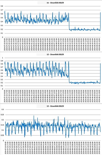

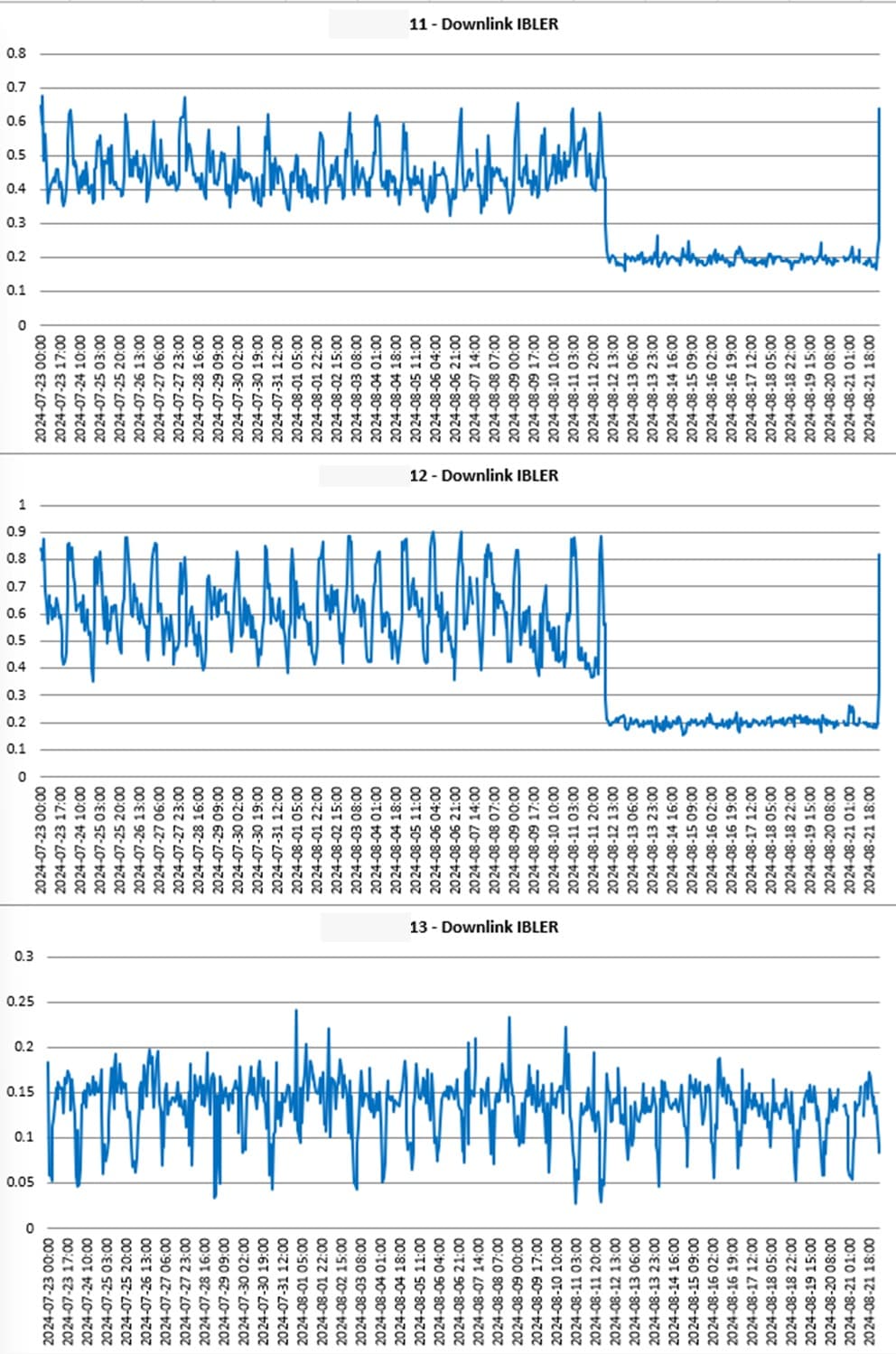

We did a bandwidth expansion in LTE carrier in band 28.
We increased from 10 MHz to 15MHz.
The operation was successful in the whole network but not in two cells * in which the ibler increased, causing a drop in degradation.
Has anyone of you experienced this issue before and have you solved it?
I already checked the inteference, I did a FTT scan and counters. No changes.
- They are the 3 cells of the same site, 2 of them got the problem

Yes, they both are ok, the third cell was also changed but it was not affected.
