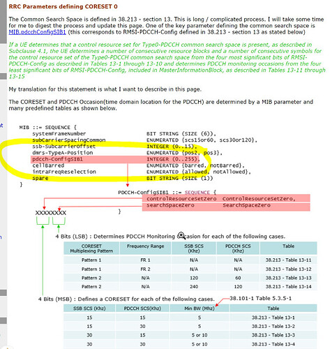

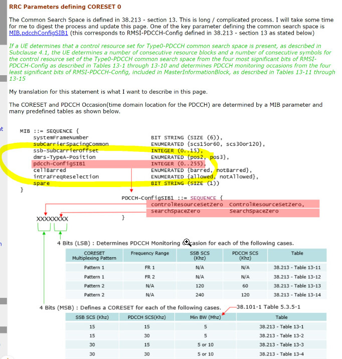

Check this: 5G_CommonSearchSpace_Type0_PDCCH
That is in pdcch_configSIB1 in MIB 5G
