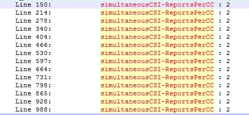

I checked one. UE Mate 40 pro of Huawei and is maximum 2:

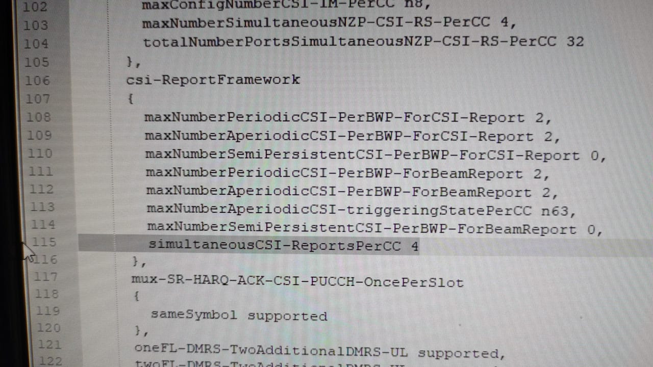

Moto EDGE is 4:
