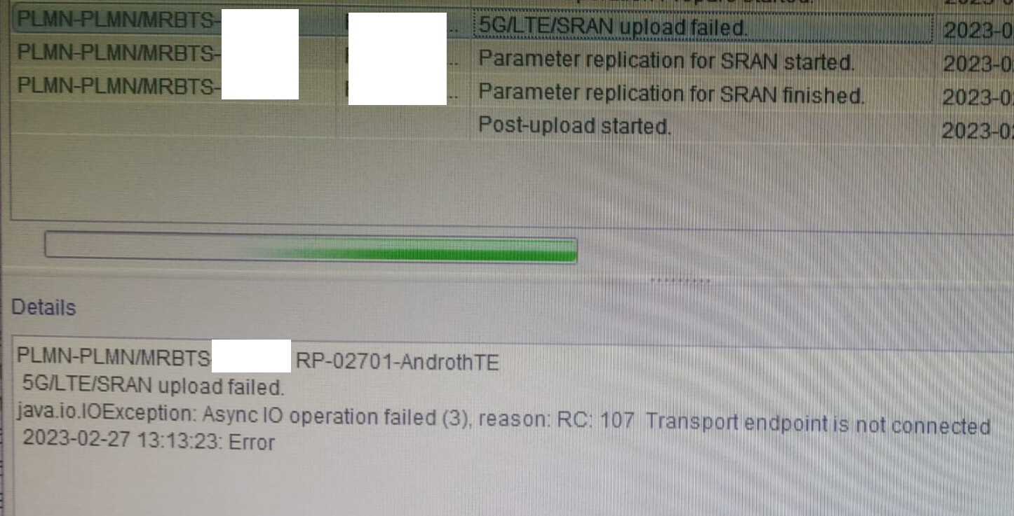

Yes, this is the error while CM upload:
Transport endpoint is not connected.
This is a Netact issue.
Ask your Netact engineer to solve it.
I got the same error some time ago and Netact engineers solved it.
It’s occuring only in few sites which are working with VSAT.
I got the same error when OM and S1 of site is UP.
Consult your Netact engineer for specific site.
Ok, I will, thanks.
There was some issue with Satellite modem configuration perhaps causing uplink congestion. Resolved after correction.
