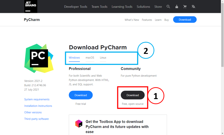

To get started, let’s go to the official website:
Official website: Download PyCharm: The Python IDE for data science and web development by JetBrains (PyCharm is one of Jetbrain’s products).
You’ll notice that PyCharm has two versions (one paid and one free).
We will install the free version (or the open-source Community Edition). To do this, we click the
Download button (1). If you are installing for another Operating System (macOS or Linux) go to the corresponding option (2).
Wait for the download to finish.

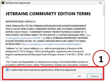

As you have selected this option, PyCharm will open. The first time it runs, you must accept the terms of use (1) to continue. There will also be another screen with a question – if you want to send anonymous data for program improvement – and then you decide. :wink:
And then (finally) PyCharm opens.

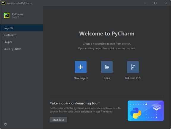

The first time you open PyCharm, it shows a welcome screen where we can create (or open) a project. (You’ll always be able to create a new project from the Menu later.)
And the first thing to do is create a Project.

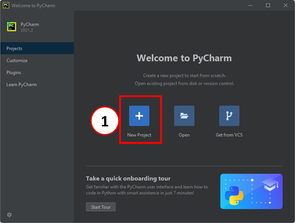

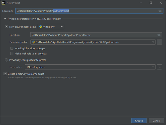

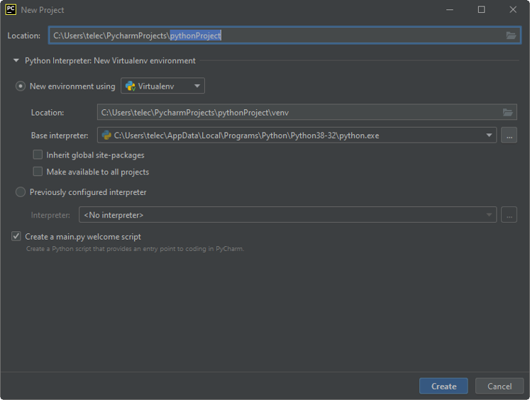

To create a new project, and start creating our codes, we click the New Project button (1).
And the “New Project” window comes up.

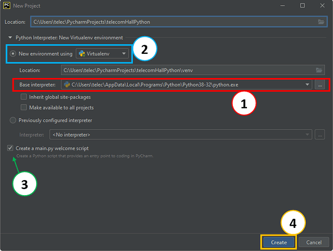

In this window, we have some simple settings to configure. The first is to set the “Name” of our project - and also its location, where we will save, store on our computer. You define the name and location.
In our example we call the project “telecomHallPython” and saved it in the suggested default directory.
Another important option is to configure python interpreter settings.
Python Interpreter
But what is a Python interpreter?
A Python System interpreter is one that comes with the installation of Python. You can use it exclusively for all Python scripts or take it as a base interpreter for Python virtual environments.
We already have Python installed on our computer, as we did in the Tutorial Installing Python.
But when you install other programs (such as PyCharm), they need to “know” which Python interpreter they will use.
But don’t worry about understanding these concepts now, and let’s just use the suggested base interpreter (1), choosing the option “New environment using: Virtualenv” (2).
You also have the option to request that a base/sample file “main.py” (3) be created. For now, we can leave selected - let it create our first file. :wink:
So, we click the “Create” button (4) – that will then create our project “telecomHallPython” already with a “main.py” file inside.

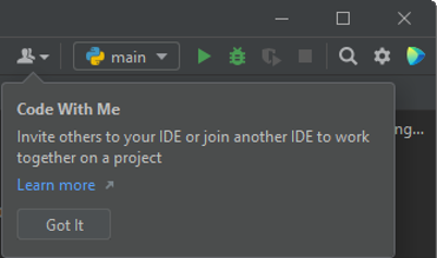

Code With Me
Of course, it’s not time yet - we still need to write our codes, and you need to learn a little bit more. But it’s good to know that PyCharm has a really cool option called “Code With Me”, where you can program with other people.
In summary you can invite others to participate in programming in your IDE or join another IDE to work together on a project. But we’ll see it later. :wink:
Click the “Got it” button to close the “Code With Me” dialog.

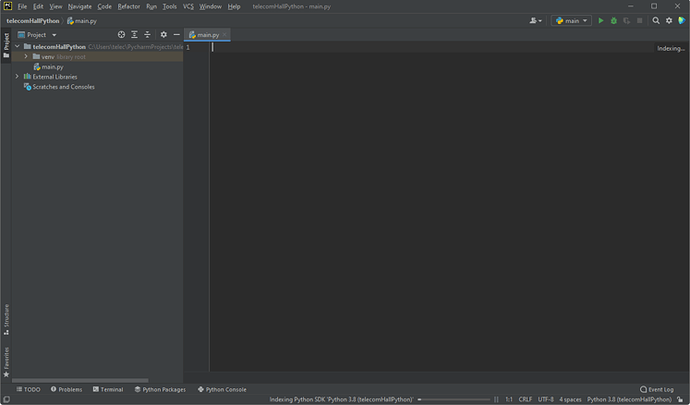

And we see the PyCharm interface, with our open project and file.
As we specified above, a file with some information / template (1) was created, ready to start writing our code in Python. But it’s already a little advanced for those who are starting, and maybe never programmed anything. Then select everything and DELETE. :blush:
Okay, now we have our file (main.py) totally empty. And we can start writing our codes. :wink:

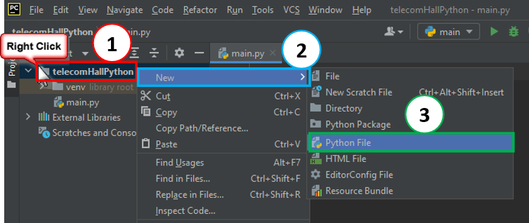

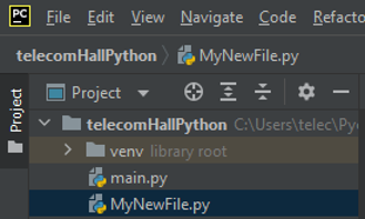

Create a new file
When we create our project (telecomHallPython) the “main.py” file was created by PyCharm (we selected this option).
But we can create another file, inside our project.
To create a file, we right-click our project (1) and choose “New” (2) → “Python file” (3).
And we can create a new file, for example with the name “MyNewFile.py” (1).
See that now, within our project we have 2 files: main.py (1) and MyNewFile.py (2).
In any of these files, our codes will work perfectly.

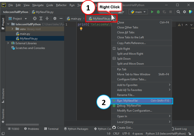

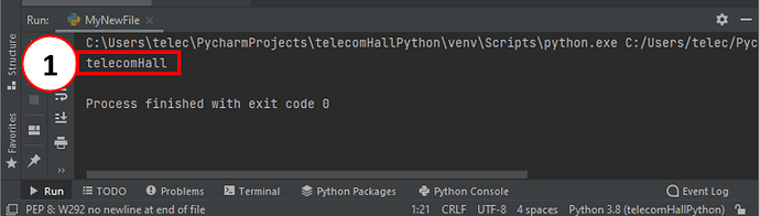

Running Code

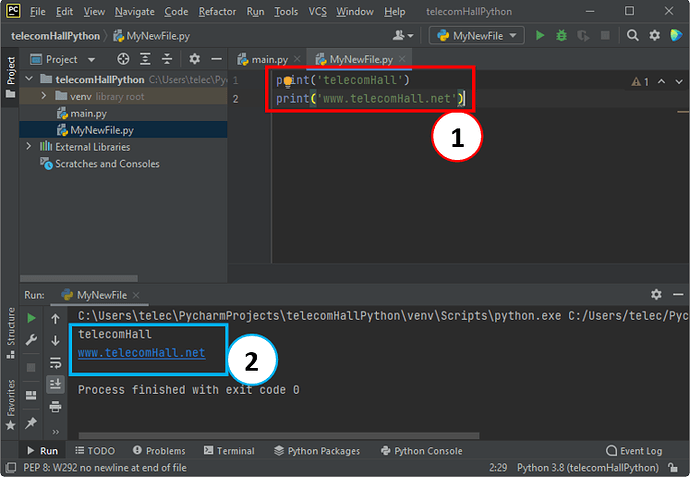

To run the code we wrote in the new “MyNewFile.py” file, right-click on its tab (1) and choose Run ‘MyNewFile’ (2).
At the bottom, PyCharm informs me that the process has been completed. And the result of the executed code (1).
If we change the code for example by adding one more print (1) and we execute, the result is updated (2).

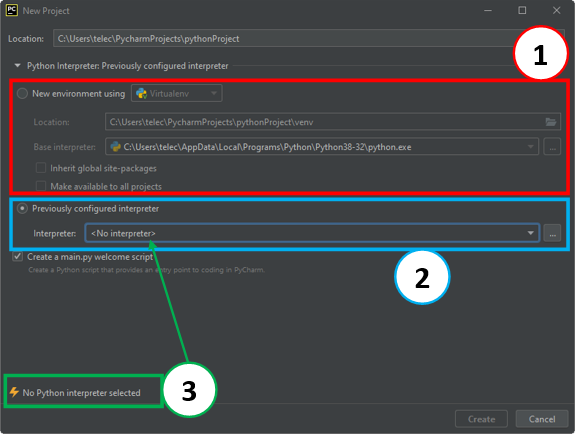

Setting up the Python Interpreter
To conclude, remember that when we create a new project, we have the option to create a project based on a “New environment using: Virtualenv” (1) or “Previously configured interpreter” (2).
But notice that PyCharm informs that we do not have Python interpreter selected - When trying to create a new project we see that there is no interpreter selected (3).
That’s because we don’t have an Interpreter set up yet.
The first option is as if I created a folder completely isolated from the other things on your computer. In the second option, you point to the installed Python. And that’s the option we use, so it’s so important to set up!
In our case it does not appear this option yet.
So, let’s see how to set up a Python interpreter in PyCharm, to use in our projects.
Option to Add
One option to add is this: In the window itself we are creating a new project, we click the 3-dots button (1) next to the “Base Interpreter” path. And in the window that opens, we copy (CTRL + C) the path (2).
And then, now in the Interpreter option of the “Previously configured interpreter” we click on the choice button with 3-dots (1).

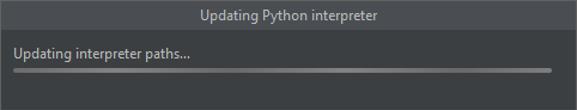

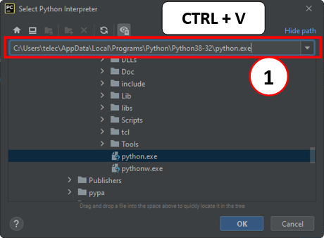

In the new window to Add Python Interpreter, select “System interpreter”(1) and again in the 3-dots button (2).
And in the window to select the Python Interpreter, paste (CTRL +V) into the text box (1) the path you copied earlier. Click the “OK” button. (And also OK in the next window).
Done: The Python Interpreter can now be selected for new projects!

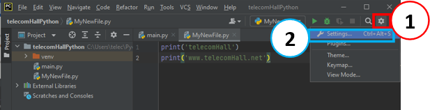

Another option to add the Python interpreter is, with the project open, clicking on the gear (1) and then "Settings… " (2).
And then clicking on the gear, choose “Show All…” (1).
And then choose which Interpreter we want to use (1). Or even add a new one (2).
