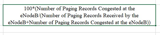

Can you paste the formula you are using to calculate congestion?

For instance KPI can go up if your Denom is lower now, which is possible if eNB is receiving less pages (possible if Core has made a change).
Both counters of Num and Den are increased.
