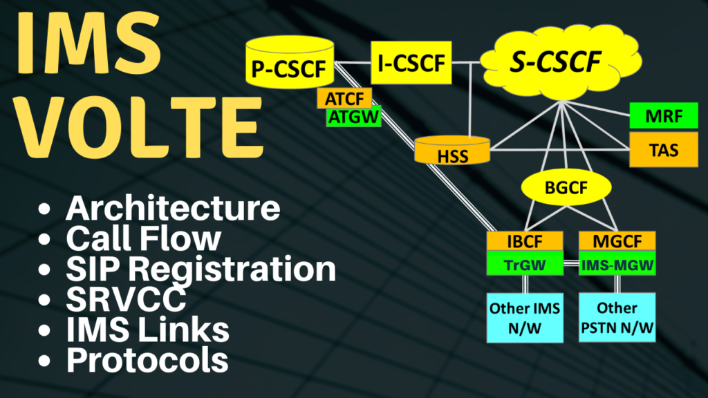

Sip 500 - Server Internal Error - VoIP Sip Codes and Solutions
What is the meaning of Sip 500 Server Internal Error?
Sip-500 means Server Internal Error. While tracking traffic if you receive this error code, probably you have a problem with the server that you are sending VoIP traffic to.

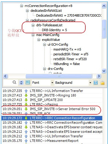

Thanks mate, but this is a general description: it doesn’t answer my question of when UE sends in Uplink, during VOLTE call setup, SIP 500 server internal error.
On this link somebody have similar error, with solution:
May it can help you?
I had a look, but it doesn’t help…
Thanks anyway!

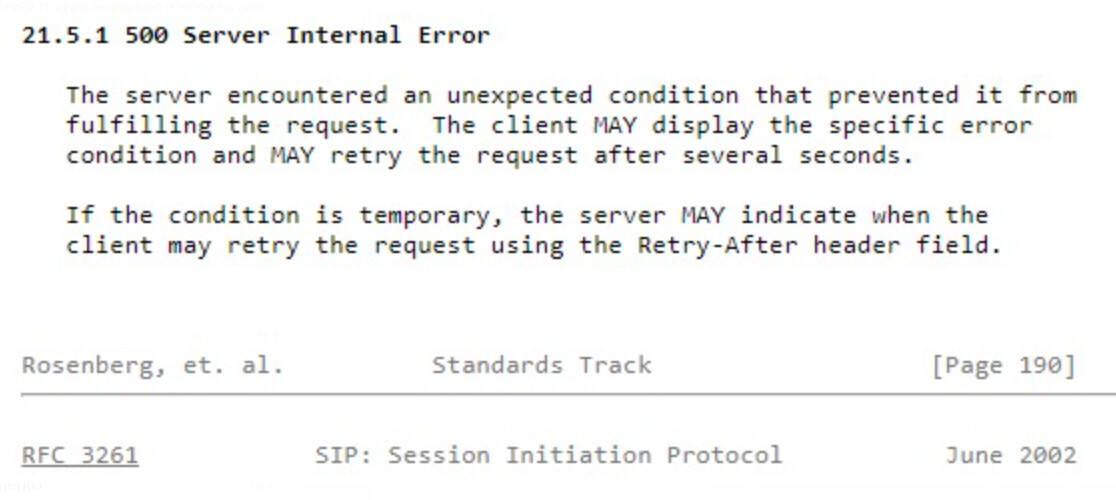

It can be triggered by any unexpected situation please see explanation from the basic sip RFC:
And I agree that this need to check Logfile.
