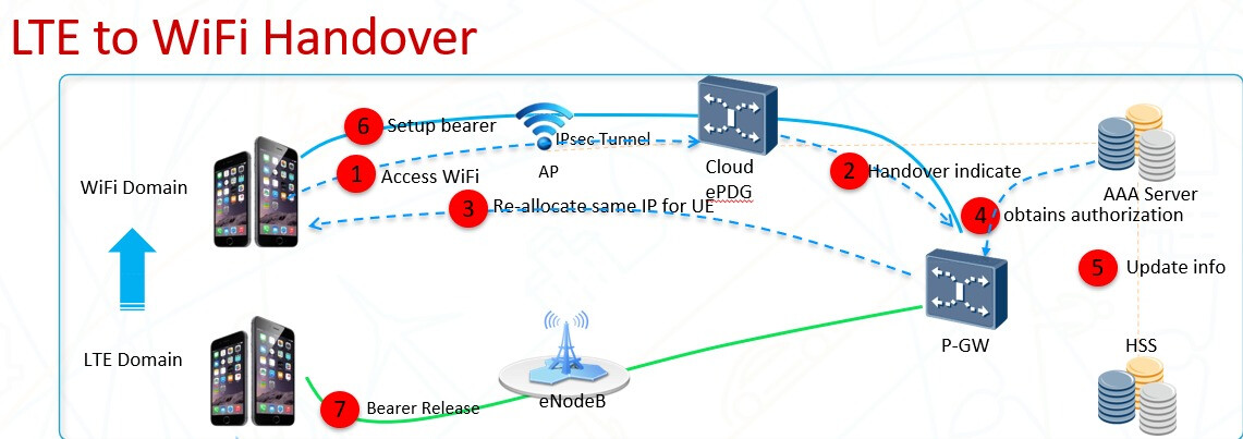

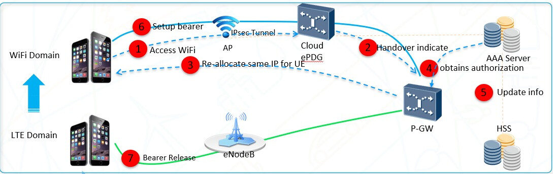

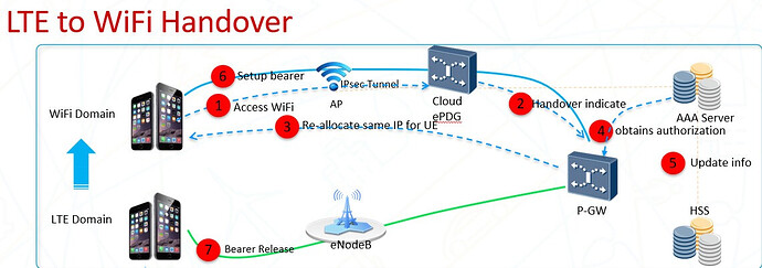

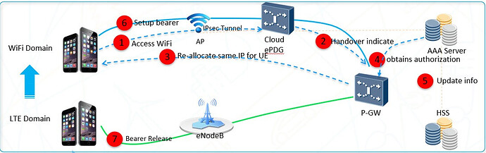

Let me show you with a flow:

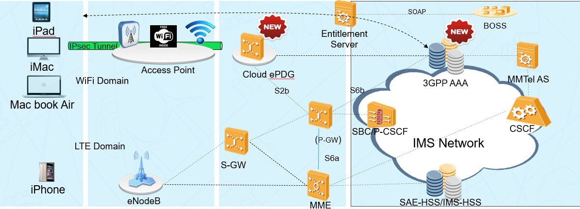

This one will better help you understand…
Switch between voWIFI anf VoLTE.
Nodes after (right side of) PGW remain the same.
Nodes on left side are changed.
It all depends on whether your network that you are connected to (irrespective of whether it is wireless or fixed network), if it has accessibility till ePDG, it will work on ViWIFI.
If you go into details , if you have VoWIFi switch enabled, an FQDN will be sent to your connected network DNS. If that DNS or the Global DNS has routing for that FQDN, accessibility till ePDG will be there and you can establish a call based on service subscription
