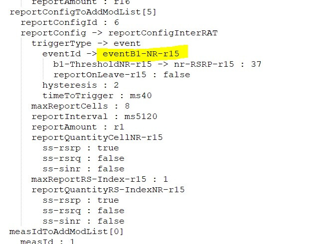

A2 is inter-freq HO, B1 is iRAT HO, right?
B1 NR is to add SCG.
A2 NR is to remove SCG.
So B1 should be like -116 dBm and A2 something like -124 dBm.
But it depends on bands.
Also time to trigger hyst etc.
