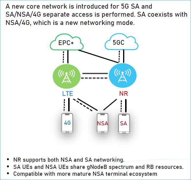

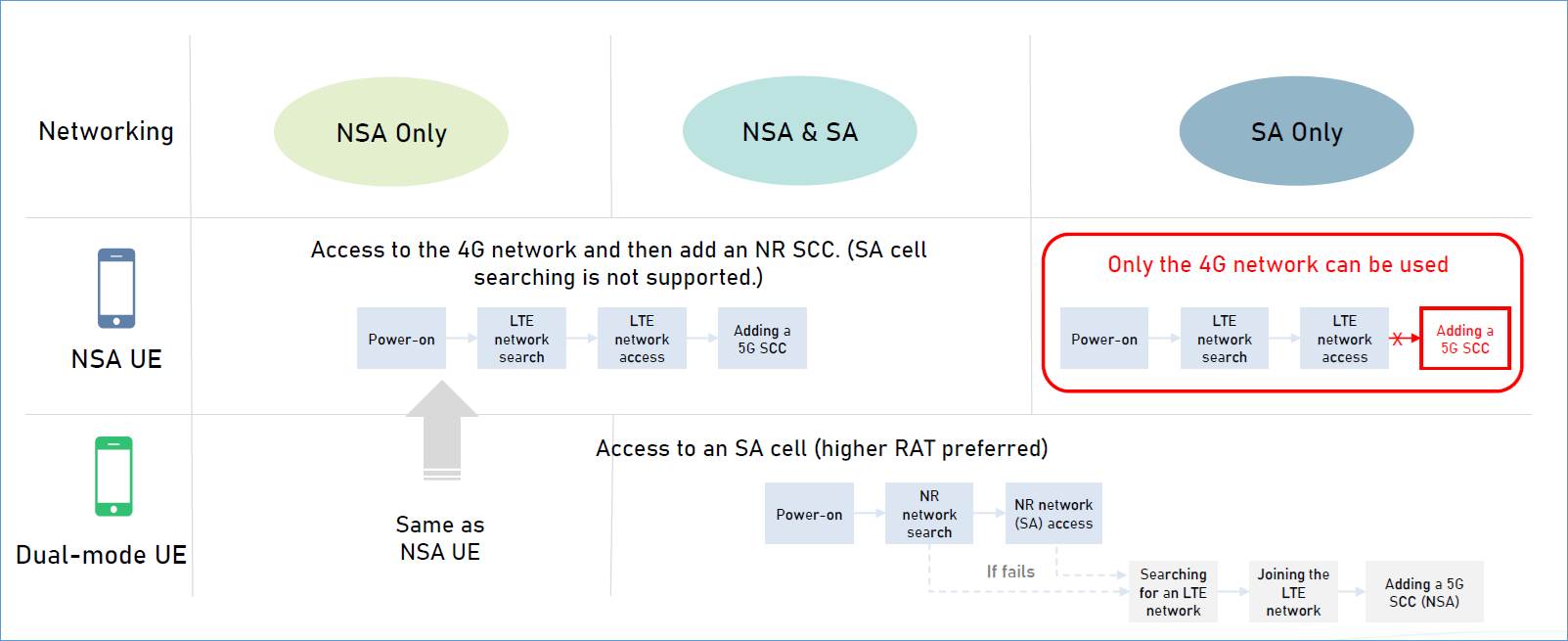

As of gNb networking mode, it is possible to set SA_NSA mode and it has no mutual exclusivity with DSS ( spectrum sharing ).
Toward Core, gNB is connected to both EPC and 5G core. Some simple illustration for connectivity and networking are here attached.
