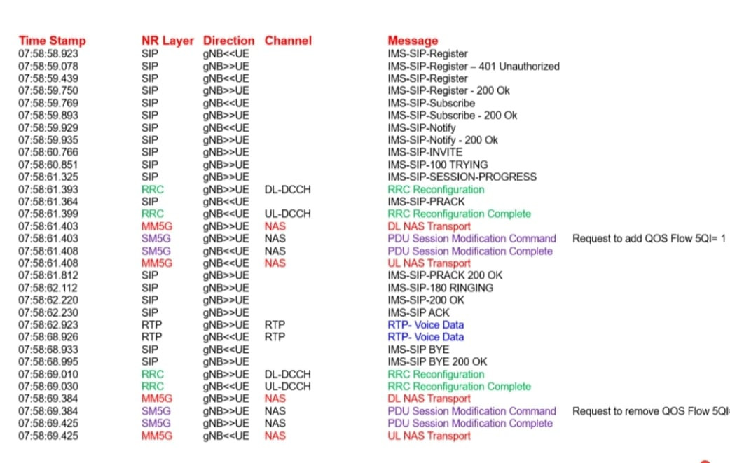

What value observed for call setup time?
How it is calculates, which 2 message difference taken?
For VoLTE it’s difference between invite and 180 ringing.
What about VoNR?
No idea, I was asked question like this, and I answerede that the metrics would be more or less same.
But, if we are going to compare the metrics between RATs, I think we can compare the same time diff between invite and 180 ringing.

More or less same like VoLTE only registration phase then ringing phase.

I think we can calculate in live logs by observing diff between invite and 180 ringing for 4 samples to conclude.
