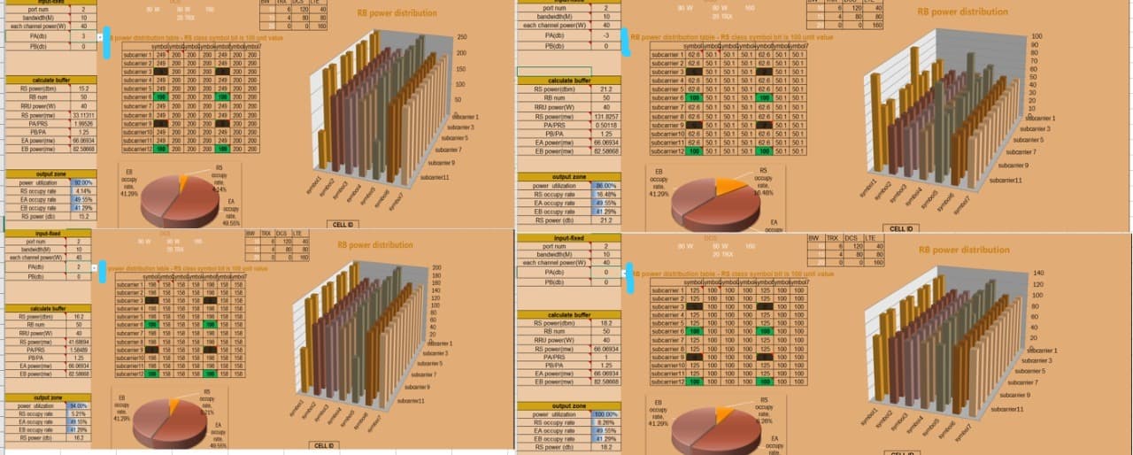

What is pros & cons of below setting PA and PB value?
What if value PA = 3 0r 2 get good throuput in field?
Or its impact on Coverage?
