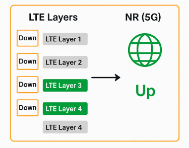

Hi Mates,
Can anyone guide me on the following query?
I have four LTE layers and one 5G (NR) layer. If two LTE layers go down while the rest remain operational, what should be the status of NR? Should it remain up or go down?
Since we define the Anchor on a site basis, how does this affect the NR layer’s behavior?
If DSS is not used, 5G should remain up as long as at least one anchor is active.

If anchoring is defined, NR will establish an ENDC session through the other two layers without any issues.
Aakas:
The UE might experience compatibility issues when the anchor shifts from L1800 to L800.
Ensure proper LTE-to-NR configuration, including X2 connections and neighbor settings.

If anchoring is only available from the down layers, colocated ENDC cannot be established. However, if X2 is defined between neighboring LTE sites and this 5G layer, it can still be used.
In our network, we have three LTE layers (L800, L1800, L2100) and one 5G layer. If any one LTE layer goes down, there is no issue, as the remaining two layers can still access 5G.

Yes, you are right. Facing a similar issue where LTE has four layers, but three are down. LTE is up on one layer, but since the anchor is defined on the 5G layer, it is showing as down, causing all five layers to be down.
We are investigating the issue - let’s see.
