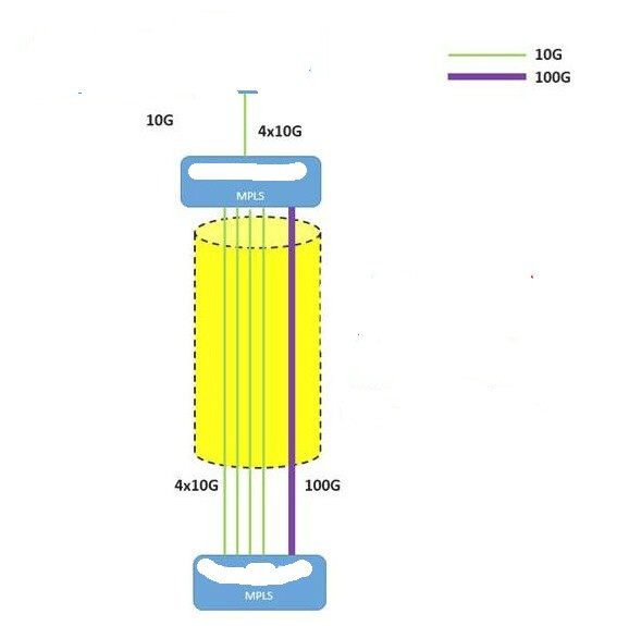

Mainly YES, but it depends on the GTP-U/MPLS link structure. In a typical network, there are usually one or two high-capacity links (e.g., 100G) and four to six lower-capacity links (e.g., 10G). If a high-capacity link becomes heavily utilized, traffic is dynamically switched to the lower-utilized links. Once the load decreases, traffic switches back to the main links.
However, if there is delay or latency during this switching, it can directly impact signaling, bearer establishment, timeouts, and retransmissions. If high GTP loss occurs, it can lead to severe deterioration in network performance, affecting EPS Fallback, voice/data continuity, and overall service quality.
