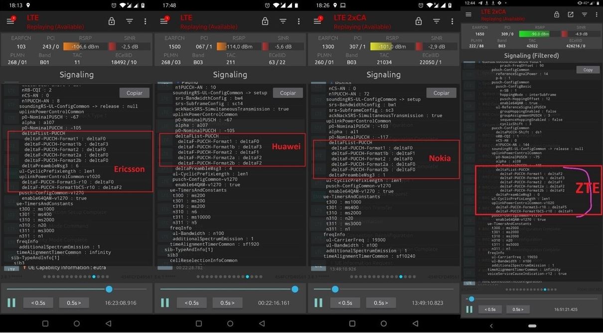

I do data collection in DFW area on commercial T-mobile network in band n71. I only have access to the UE side logs and not the NW side logs. Is there any way to tell from the UE side logs who is the NW radio vendor (i.e., Nokia or Ericsson).

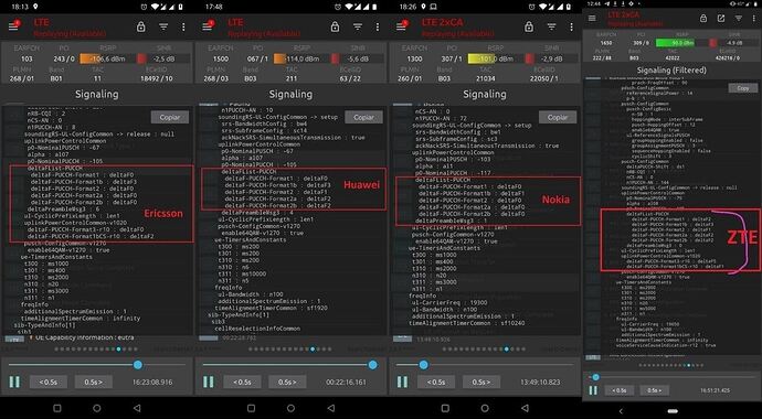

Yes, there is a way.
Look at SIB 2 in LTE and values are like in the attached picture.
Hi!
Could you specify a bit how exactly you are able to see the difference between vendors in your example?
