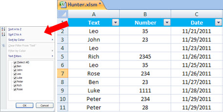

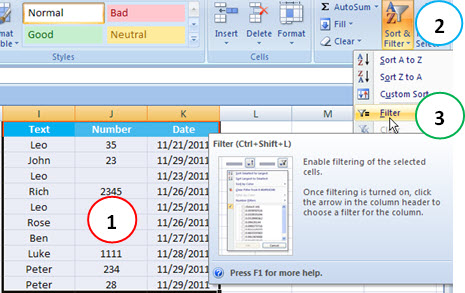

To create an ‘Auto Filter’ in Excel, select the desired data (1), and then go to the Menu: ‘Editing’ -> ‘Sort & Filter’ (2) -> ‘Filter’ (3).
Clicking the arrows next to each field, you have a list of options with the existing values in that column.
As already mentioned, this function is very good and functional, and widely used. But it’s not very ‘friendly’, or rather: we can improve it.

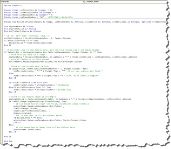

The VBA code for handling auto filter is very simple and has been sent to Hunter Users (donors), ie, those who once contributed to the telecomhall.

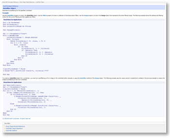

If you are not a donor, and have your own macros and codes, insert a code in any spreadsheet, for example right-clicking on it (1) and choosing ‘View Code’ (2).
So, write your own code to manipulate your data. Don’t worry, you don’t need to be an expert, and also don’t to write too much code: notice that in the case of the demonstration of this code (Hunter xFilter) we use less than 50 lines in total (except for comments).
Basically, you just need to manipulate the ‘AutoFilter’ object properties, and its parameters can be found through the Excel Help for ‘AutoFilter’, including a complete example of its use.

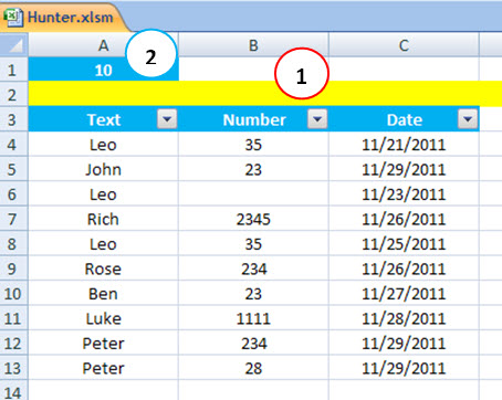

First, we adjust the way our filter presents the data. In this case, we inserted a row above the header, paint it with yellow color (1). This is the line where we enter the values or criteria for the filter.
And to get a little more interesting, we insert one more line, writing the formula ‘= SUBTOTAL (3,A4:A65536)’ at first cell on that line (2), which therefore will contain information on how many rows are filtered.

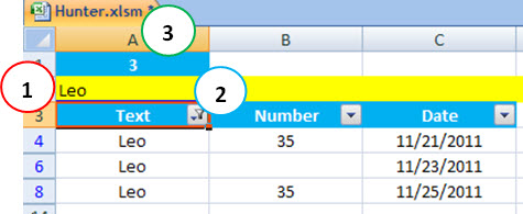

When typing a value in the yellow line above the headers, the macro uses this value and applies the ‘Auto Filter’ for the corresponding column!
For example, typing ‘Leo’ and pressing ‘Enter’ (1), ‘Auto Filter’ is automatically applied (2), and we have only three filtered values (3) - only for lines with ‘Leo’ in the ‘Text’ column.

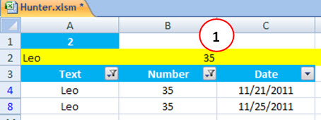

If we type another value, such as the number ‘35’ in the ‘Number’ column (1), the macro continues by filtering the data further.

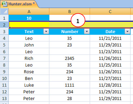

Selecting yellow line (1), and clearing its contents - for example pressing the ‘Delete’ key when the row is selected - we have all table data (all original data) without any filter criteria applied.

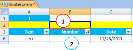

To finish, the macro has a special option to filter ‘Empty’ values by typing ‘=’ in the desired column. And also an option to identify ‘Not Empty’ values, in this case while typing ‘<>’.
For example, see what happens when we type ‘=’ (1) immediately above the ‘Number’ column: the filter is applied, and we show only the rows (2) of our table where ‘Number’ field is blank (or empty).
