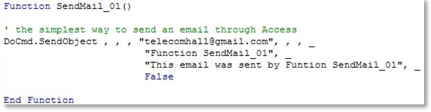

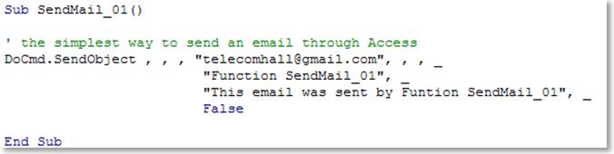

Sending a simple e-mail (Staff SendMail_01)

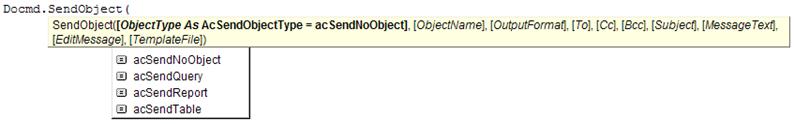

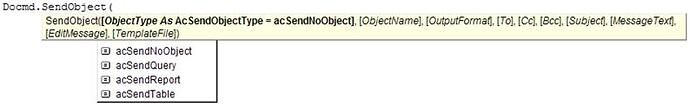

The simplest way to send an email through VBA in Access is using the command SendObject, and writing arguments, or the required details for sending and recipient subject, etc.. In VBA, we have seen that whenever we run a command started with ‘DoCmd.’ Followed by the desired command.
For commands that have arguments - as the case of SendObject - after you type the first ‘(’, appear the required options and options that you can type highlighted in yellow. Bold appears the first argument, as well as their options.
Note: The command is called SendObject, but you have the option not to send any object (constant acSendNoObject), so you can send an email with text only if you wish.
Continue typing the command suggested in obeying the yellow text, ie typing the comma, is the next bold argument, and so on for each option until the end.
Following is the full command, and a brief description of what each argument represents.
DoCmd.SendObject (ObjectType, ObjectName, outputformat, To, Cc, Bcc, Subject, MessageText, EditMessage, templateFiles)
  • ObjectType : the pattern of this argument is acSendNoObject, which means not sending any object, but you can send any Access object like a table or query, thus they should be chosen appropriate constant acSendDataAccessPage, acSendForm, acSendModule, acSendQuery, or acSendReport acSendTable (the latter for instance if you want to send an attached table.)
  • ObjectName : an optional string that is the valid name of the object - if you are sending one. If you leave these first two options empty Access sends the email without any object.
  • outputformat : optional.
  • To : an expression with optional text message recipients. The recipients must be separated by ‘’ (or the list separator, according to what you set in Regional Options in Control Panel). If there are errors with the list separator, will give an error when the application of e-mail tries to send the message, and then you adjust. If this argument is empty, Access will ask what are the intended recipients.
  • Cc and Bcc : optional expressions of text, like what we saw for To, except that if they are empty, Access and ignores the corresponding fields the message remains empty.
  • Subject : An optional expression text contend the text you want to put in the subject line of your e-mail. If you leave this argument blank, the matter goes blank.
  • MessageText : An optional string expression containing the text you want included in the message body. If empty, the body will also empty.
  • EditMessage : optional argument. Use True (-1) to open the application of standard email, allowing you to edit the message before sending. Use (0) to send the message without editing. If you leave this argument blank, the default (True) is assumed.
  • templateFiles : to use an HTML file as template. Let’s not talk about it today, we’ll look at another time.
  • Well, nobody will be decorating it, and it’s easier to do and understand by example. Below is a practical example:
That is, when it runs the function SendMail_01 will be sent an email to telecomhall@gmail.com with the subject ‘Function SendMail_01’ and with the text 'This and email was sent automatically by SendMail_01 Function 'in the body of the email. See how simple it is? (Enter F5 or F8 and check that the e-mail is sent).

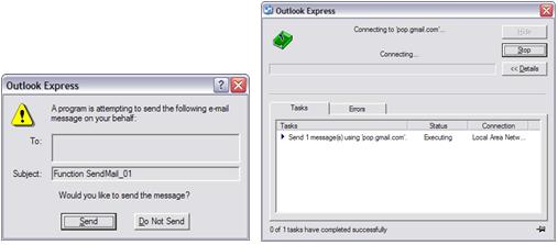

Outlook Security
Depending on the application of e-mail you use, you may receive a dialog box informing you that some e-mail is trying to be sent automatically, and if you want to allow this e-mail is sent.
This is a security configuration (as shown for Outlook on the image above), and it can not be canceled. In the future we will see that some modules need Hunter email automatically, and then we’ll see how to avoid this security lock.
Anyway, whatever the confirmation request, then click Allow. Below, the request from Outlook Express, with the submission.

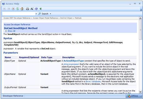

Help
You can and should consult the help of this command, and all others who use it. Do this always, is very good practice! For this, the VBE, select the command and click F1. Help you find further examples of use.

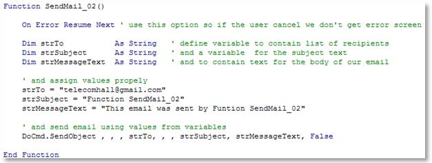

Sending a simple e-mail (Staff SendMail_02)
Okay, as we have seen e-mail. But has more work than using the client send e-mail, what advantage has it
Of course we will not be entering the arguments and options of the email as we did above. The great advantage of the program is allowing us to use variables, ie, we can get all of our input data from various sources, and mount command in accordance with what we need.
For example, this function does the same thing before, but now uses variables.
In this particular example, the variable values are assigned directly, but in future we will see that we can assign the value of these variables with data from several sources, such as tables, Excel files, text files , Images, etc..
In addition, we may use HTML in variable that contains the text of the message, then our limit is our creativity
Do not worry, whenever a module used for sending e-mail, you receive the full code that already does everything, including riding the HTML or other more advanced functionality. But it is very important that you go along and understand each new tutorial. No accumulation, otherwise you will not mind.

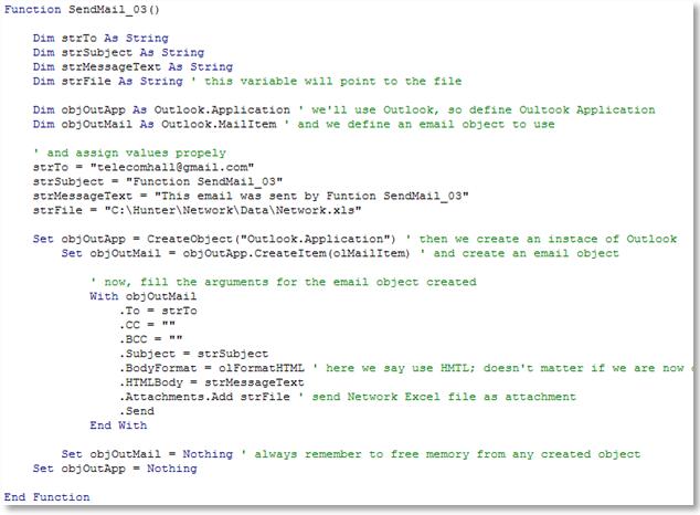

Sending an e-mail via Outlook using VBA (Staff SendMail_03)

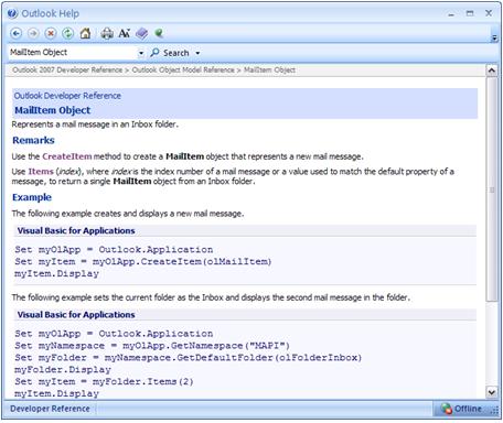

Another way to send email via VBA application itself is using the e-mail (referencing the same). Thus, we create an object in memory containing the application. Then we create an object of this application - if an object email. Finally, configure the properties of that object e-mail with the information you want to send.
Note that the arguments are much the same.
This role specifically Network.xls also send the file, located in the C:\Hunter\Network\Data\ as attached file. For this we use the argument Attachments.Add followed by the name of the file you wish to attach.
Reference

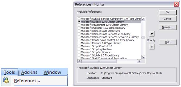

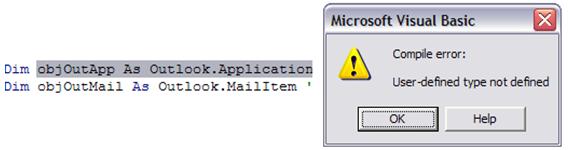

Remember that when we refer to another program, we need to include a reference library in the module, but an error occurs as shown below.
Thus, open the VBE, go to the Tools menu (1) → References (2), and select Microsfot Outlook Object Library X, where X is the version Outlook you use.
Note: The file sent to a reference library 12, referring to Office 2007. If you use another version, remember to make this correction.

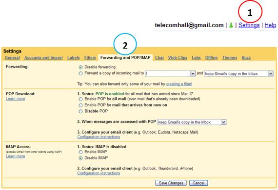

The first action to take is to activate the Pop To do this, log into your Gmail account, and click Settings (1) at the top right and then tab select the Forwarding and POP / IMAP (2).
Choose the desired setting - for all e-mails or e-mail that arrives from now on. In field 2, you have the option to keep a copy of messages on the Gmail server or you can choose to delete them. The field number 3 is Google’s own instructions for you to configure your email client, eg Outlook or Eudora.
After enabling POP, remember to click the Save button! Okay, let’s now configure your client.

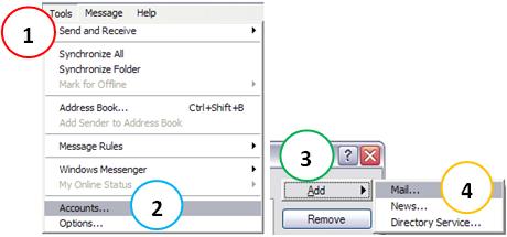

First, start Outlook Express. If this is the first time that it starts, skip the next paragraph. Otherwise, click on Tools (1) → Accounts … (2), and then in the new window, choose Add (3) → E-mail (4).

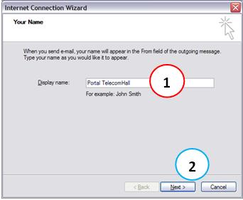

In this new window you must enter your name (1). This is the name that will appear to people who receive their e-mails. Click the Next button (2). In our case typed TelecomHall Portal, you must enter your name.

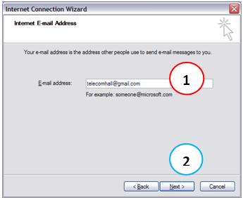

Now enter your e-mail that is being set (1) and click the Next button (2). In our case, we typed telecomhall@gmail.com, you must enter your e-mail.

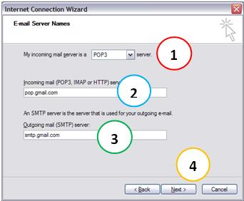

We did the most important part, which is to inform that our POP and SMTP server. For the server, select POP3 (1). E-mail Output type pop.gmail.com (2) and E-mail Input type smtp.gmail.com (3). Click the Next button (4).

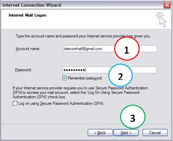

In the new window, enter your e-mail account from Google (1) and also your password (2), and click the Next button (3).

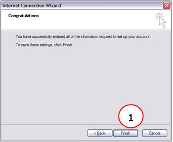

Your account has been set, but still not finished. To continue, click the Finish button (1), which just means that we put the account information successfully, but still not enough for your Outlook Express to send or receive messages.
Wee need to do some little more settings, with a more advanced, but not too complicated.

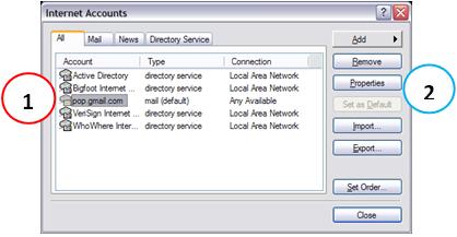

Go back Menu Tools → Accounts as we did earlier. Now in the open window appears to account pop.gmail.com (1). Select this account and click Properties (2).

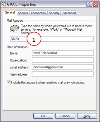

In the new window, give a more meaningful name to your account, such as GMAIL (1).

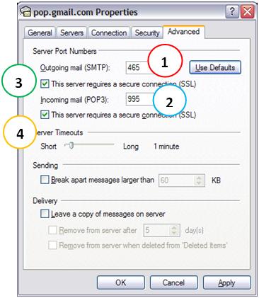

Finally, select the Advanced tab to configure the ports to which your Outlook Express will communicate with the server. Enter 465 for SMTP (1) and 995 for POP3 (2) and select the options for SSL (3) and (4).
Ready. Click the OK button - or Apply and then the OK button. If you have no other email account configured in Outlook Express, this account (only) is already as default. Otherwise, you can put it as default - recommended and required if you use it in automated modules Hunter - through the right mouse button menu, clicking on the account, and choosing Set As Default.
