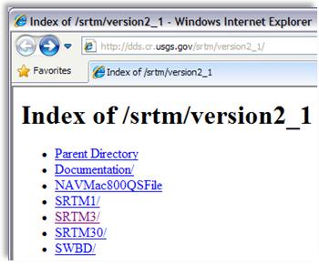

The SRTM data can be obtained directly through the address: http://dds.cr.usgs.gov/srtm/version2_1/ navigating to the directory SRTM.

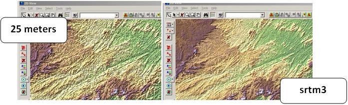

Preliminary analysis of data SRTM3 (with 90m resolution) repeatedly shows a detail somehow BETTER than the altimetry data from commercial, for example, 25m.
This can be seen in the figures below.

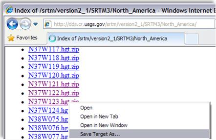

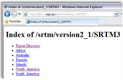

First, let’s download the file N37W123.hgt. Enter your starting address, and click SRTM3.
Then click in North America.
In the next window, locate the desired file N37W123.hgt, right-click and save it in C:\Hunter\Data\SRTM\ (create this directory using Windows Explorer).
Note: The file type is downloaded is compressed (ZIP), so extract the original file for that folder.

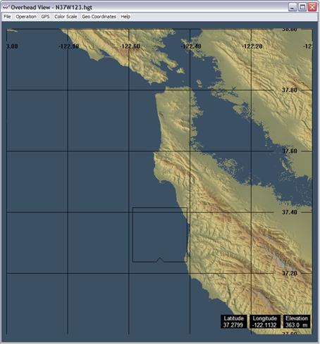

After installing, start 3dem. Once started, the program asks what type of file you want to open. Select Date SRTM (hgt, bil) and click the OK button.
Then navigate to the directory where you downloaded the file (C:\Hunter\Data\SRTM) and click Open.
The data can now be viewed in the program interface 3DEM.
We now save the HGT to DEM format. To do this go to Menu: File (1) → Save USGS ASCII DEM (2).

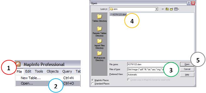

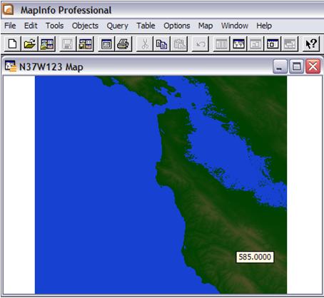

And now let’s open the file in MapInfo. To do this, go to Menu: File (1) → Open … (2), select files of type GRID Image (3) navigate to the directory where the files are as mentioned above by selecting the same (4) and click the Open button (5).
The result is shown. Note that each point has a height information, you can see this by passing the mouse over any point.
Finally, use the tool Gelink, as we saw in the previous tutorial, and save the result as a KML file (Google Earth).
The result as seen in the following figure is quite satisfactory.

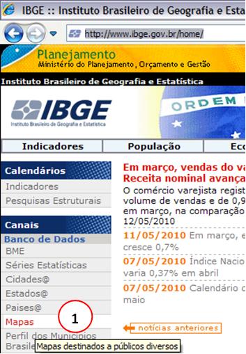

To begin, visit the IBGE: http://www.ibge.gov.br/ and click on Maps (1).

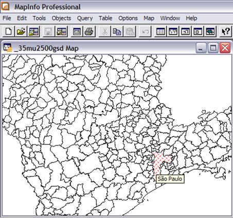

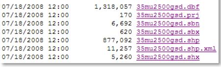

We demonstrate, for instance, obtaining the vector data of the State of São Paulo, and its municipalities.

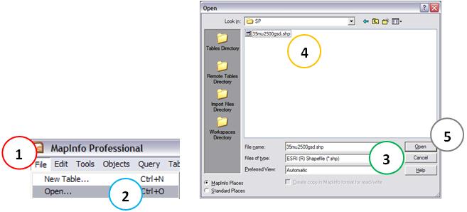

First, access the Link State (PSU) as shown above, choose the UF SP, and download all the files to the directory C: \ Hunter \ Data \ ibge \ UF \ (you must first create this directory).
Then start the MapInfo and access the menu: File (1) → Open … (2), select files of type ESRI ® Shapefile (3), navigate to the directory where the files are as mentioned above by selecting the same (4) and click the Open button (5).
For organization, save the file tab in the same folder where the other downloaded by clicking the Save button (1) and the OK button (2) in the new dialog box that arise.
There, the data are already available.
