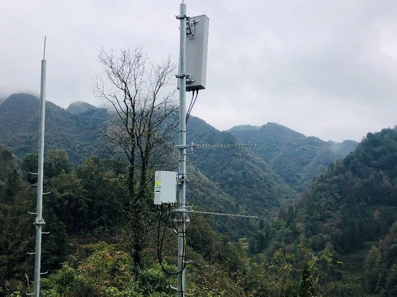

In 2019 Huawei trial a project called ‘rural star’ in Vietnam.
Using 4G LTE wireless 5Mhz as transmission link for remote 3G site.
The distance from 4G donor site to remote 3G site is ~ 10km.
In remote 3G site, there are instaled new Yagi antenna to receive LTE signal.
Rural Star already implemented in several spots here in Indonesia.
Not only 3G site, but also 4G as well. As we have 15Mhz bandwidth in 900Mhz spectrum.
It works quite well especially for tourism resorts & vacation spots (which located in the middle of nowehere).
The drawback is availability sometimes degrading over time.
